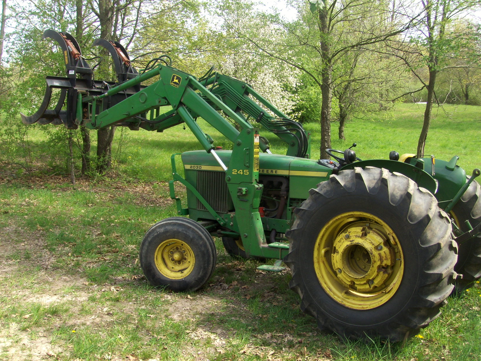

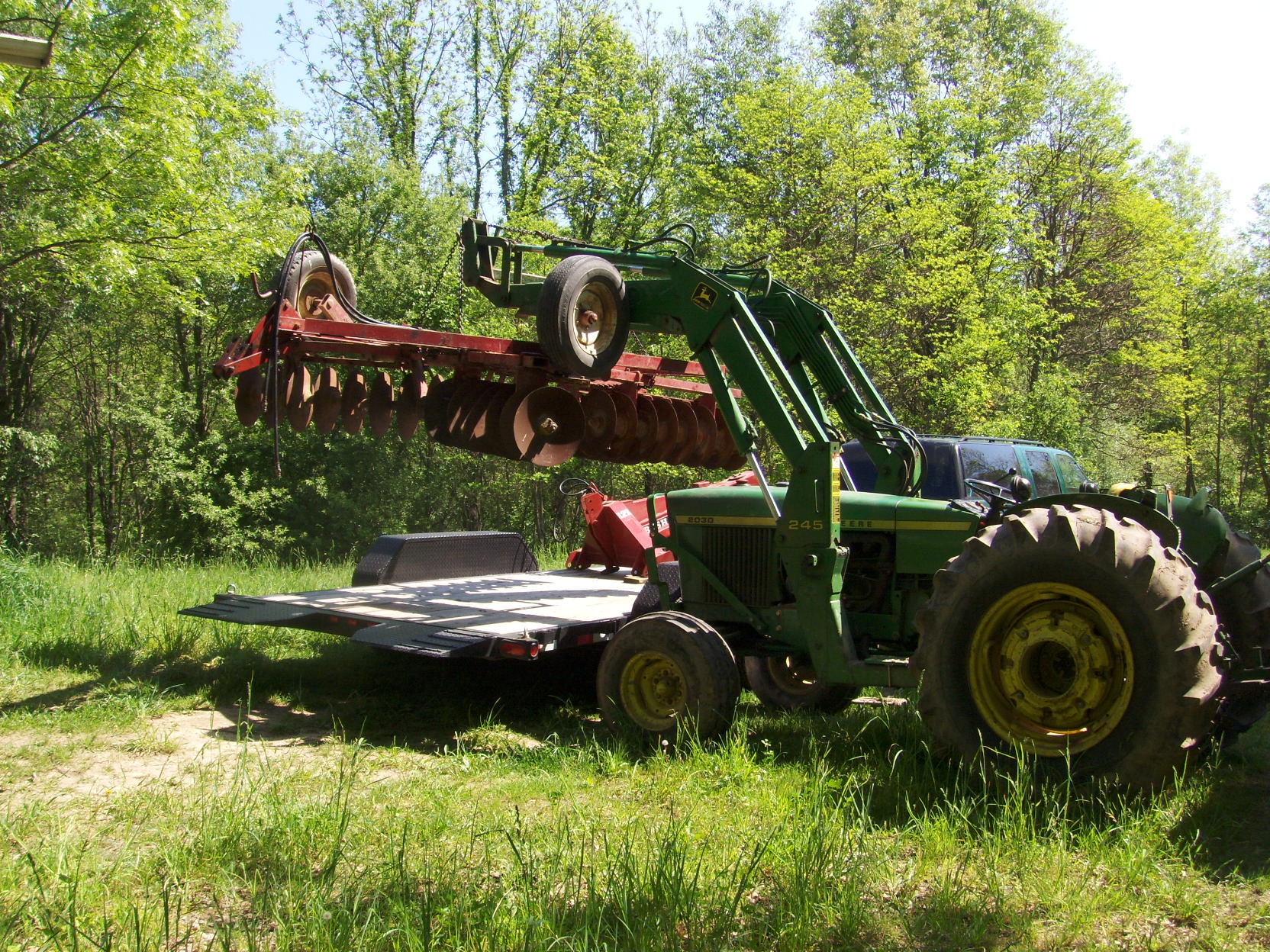

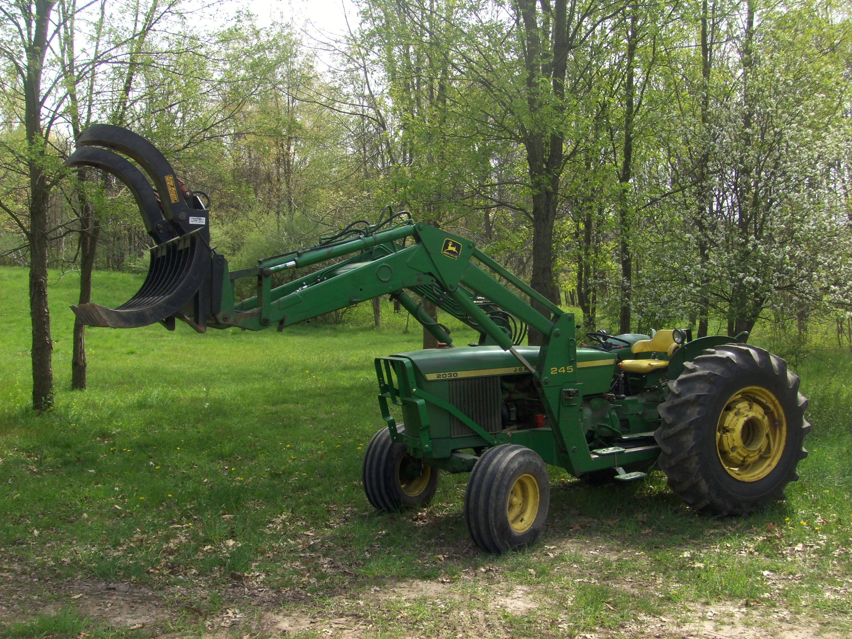

Here are some differences:
Engine; gas, diesel
Trans; 8 speed collar shift, 8 speed collar shift with HI- LO, Reverser
Front axle; swept back adjustable, straight (non adjustable), straight adjustable, HD straight adjustable
Exhaust; vertical, horizontal
PTO; none, 540 rear, 540/1000 rear, 540/1000 rear & 1000 mid
PTO clutch; one stage of two stage foot clutch, hydraulic lever operated
Fenders; shell, row crop
Rear axles; rack and pinion, flanged
Rear SCVs; none, one, two
Lower 3pt arms; fixed, telescoping
Engine side plates/frames; with, without
Wheels & Tires; MANY! I have 16.9 - 28 rears on power adjust wheels 11L- 15 fronts
Hydraulic pump; two sizes
I am sure there are other options I am not aware of

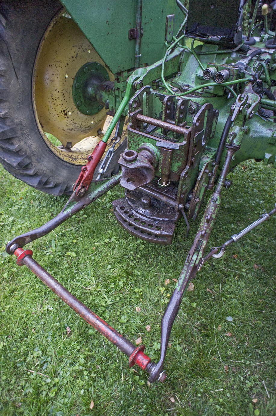

   / looking for wiring diagram of JD 2030
thanks! and sorry, my misunderstanding: yes the number is the chassis number; the engine number is 142XXX CD
it's a diesel 8speed w hi/lo, 2wd, short vertical exhaust, power steering, 540 pto in there, tires 13.6.r x 36 - 7.5 x 16, and more that I don't know (I am just a Newbee)
adding some pictures will help, I guess... and you might be able to tell much more!
(oh, and btw: your 2030 looks impressive - wish I had a front loader like that! :))
