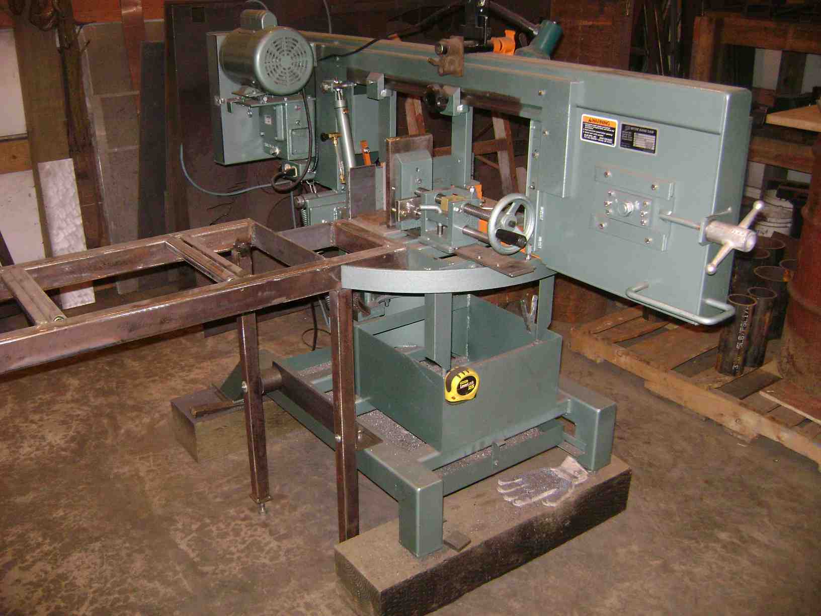

Yes the Ellis would be nice. If I had to use a production saw then yes Ellis would be on the short list.
Hello gentleman! My first post here on your fine forum.:cool:
I don't know if I would consider an Ellis saw a production saw. An elaborate home hobbits saw yes;). About a year ago I was looking to upgrade from my ENCO saw, Ellis was highly recommended over and over, but I just couldn't believe a saw of this size would cut without fluid. Only saws I ever seen of this size are at the steel supplies, which are generally HEM saws. Once it was explained to me an Ellis isn't really designed to cut every minute of every day I gambled and bought an 1800. What a blessing when cutting angles. The material stays in place, and the saw head swivels to the desired angle. Cutting angles with my ENCO saw was a nightmare!:rolleyes: In fact I only tried it once, and never again. I used my portable band saw, O/A torch, or plasma. The scale on the Ellis is extremely accurate. I don't miss the mess of wet floors, or liquid all over the material that has to be wiped off after each cut!
Does your Ellis have the air cooling option? I was considering converting a dry saw to wet, but after hearing of air cooling on an Ellis, I am considering trying that.

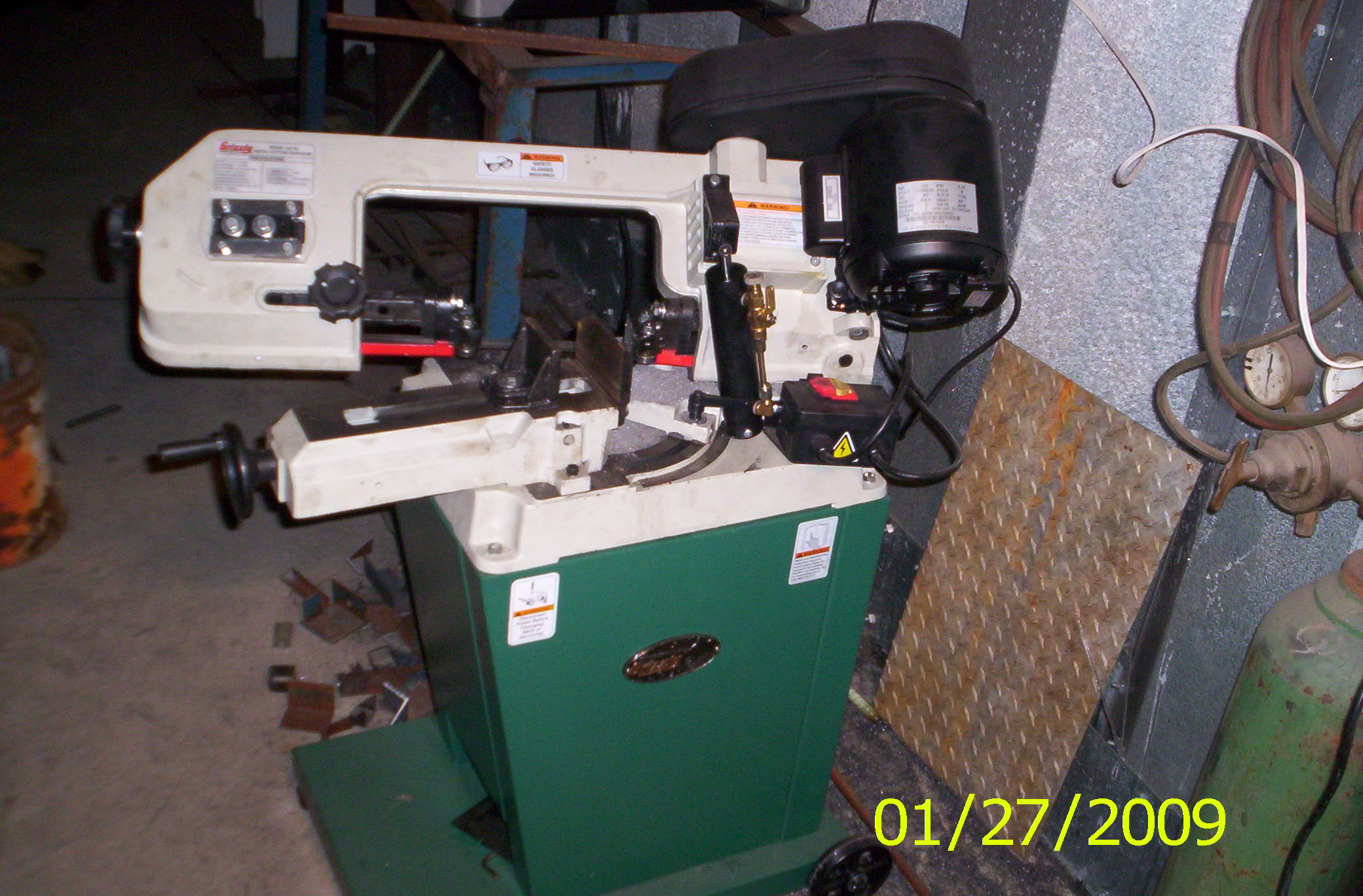

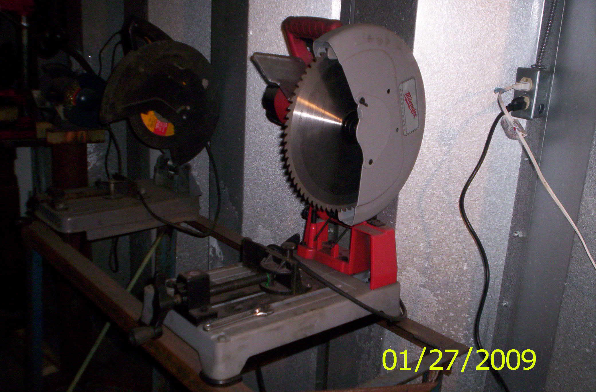

the bandsaw is the way to go. i have a brand new milwaukee 14" heavy duty, metal blade chop saw 500.00 bucks it is a great saw however the blade will not last long unless it is used in 100 percent mild thin steel. it tells you in the book mild steel only. i made about 100 cuts in a little stronger steel tubing and the blade is shot all it does is burn the steel now. new blades are $170.00.wish i would have gotten the abrasive blade saw i cant put one on this saw the rpms are slower. i went and got a bandsaw from grizzly with the swivel head dry cut and i know i made over 100 cuts on the cheap blade in the same steel as the chop saw.the blade shows no dulling yet,the saw works great.i did buy a bi-metal blade for it $23.00 will put that on when the other one is shot.

are you telling me i can get blades that will cut harder steel. T72 i think is what the blade is for my milwaulkee and it was the same on the dewalt i looked at. the owners manual tells you the saw(blade) will only cut mild steel. please enlighten me because i already ruined one blade with very little cutting new blades are $170.00.
