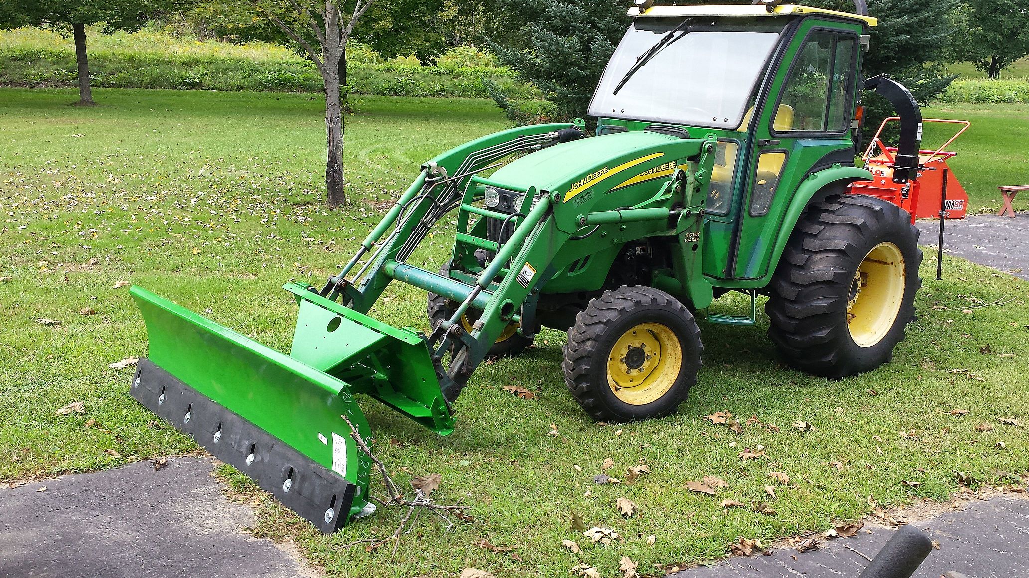

Coyote machine do you have any pictures of your HLA plow, and who made it or who do you recommend. I'm looking for something to help with all the lake effect snow we get here, I was looking at 3 point snowblowers, but I'm no sold on anything yet.

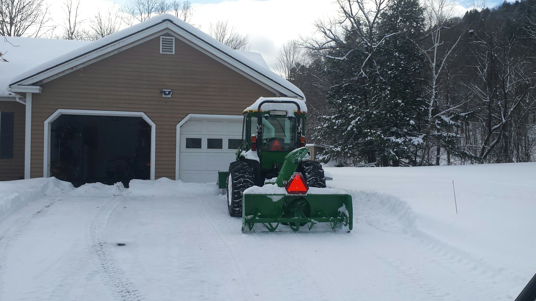

The main advantage to a snow blower is it moves the snow several feet from where you're clearing. A plow just, as can be expected, moves it to the side.
In Vermont, we can expect a lot of snow over the course of the season...quite often, totaling several feet
I have a plow on the front, blower on the 3PH
So, IMHO...it depends on how much snow you typically get in your area...
