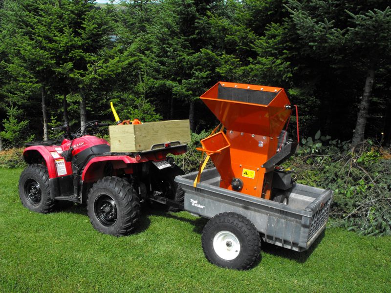

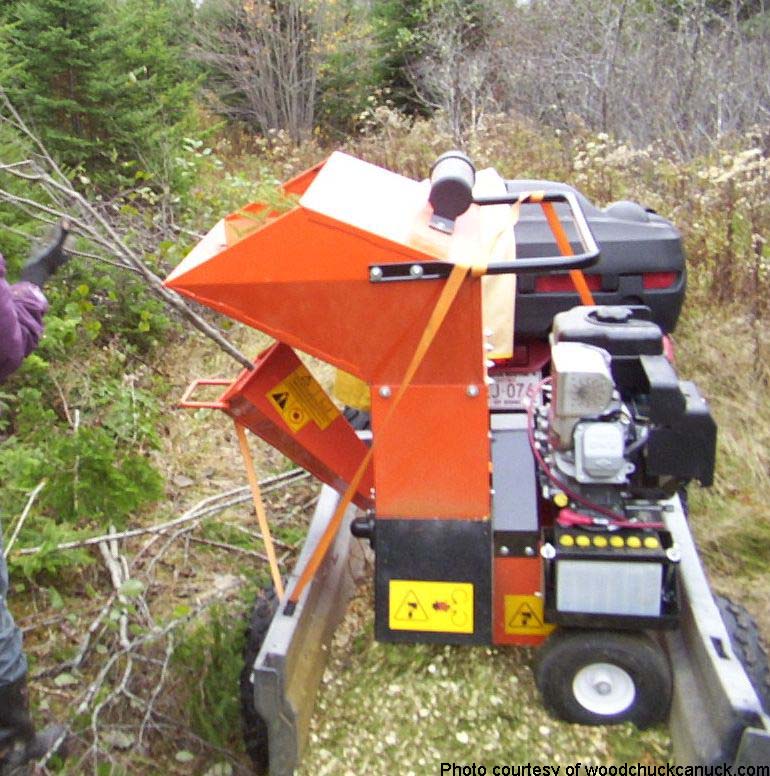

I currently have a Bearcat 70085 which self feeds 3" material and takes up to 3/4 brush in the shredder. It will eat anything I can fit into it. Only thing I wish I had was the blower but it was an $800 option. But since I am now in the market for a 35 hp tractor I will be looking to sell this unit and get either a Wallenstein BXM32 (chipper shredder) or get the BX42r with hyd feed (no shredder). The Wallenstein's list price is about the same as that Bearcat, only the Wally has the blower too. Trade off I guess, one is free standing, the other requires the PTO, one has blower, the other doesn't. Having run the Bearcat, I wish we had the blower.
