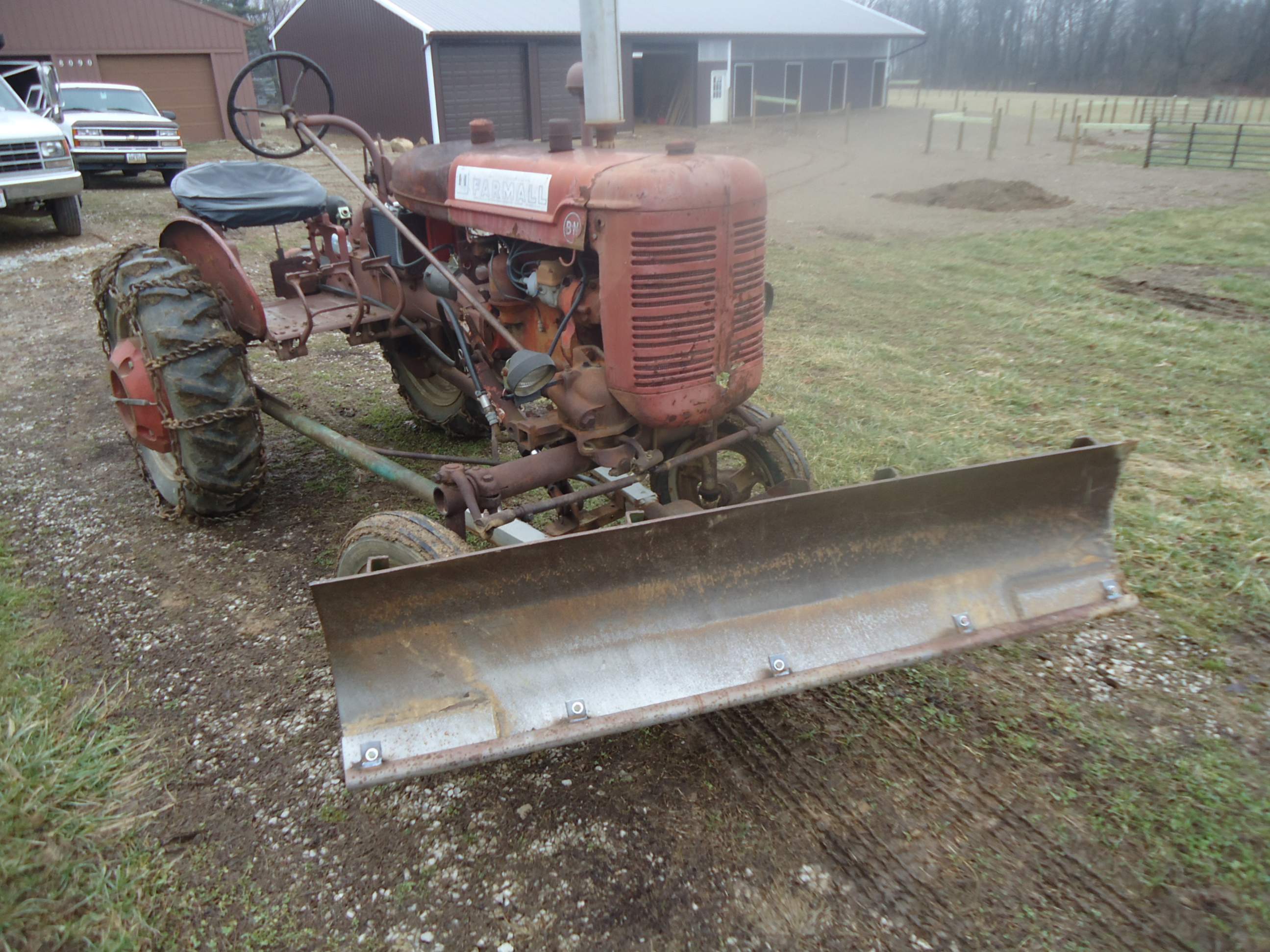

I see it has the industrial front axle. Square, or diamond shaped looking at it endo, plus the brace running back to the torque tube. That's worth a few bucks right there.
If you don't have any use for the sickle bar mower, you can always put it back on CL. Like you said, for sale, or trade for a front mounted blade. There seem to be a lot of the A's and Super A's being bought, and put to work. With mowing season coming up, I really don't think you'll have a hard time selling it.
Would have been sweeter it it would have had the Fast Hitch update, but depends on what all you plan to use it for. Would love to have a SA with FH, and a single bottom plow to play with at antique tractor plowing days around here.
With the mower, blade, and industrial front axle, I'd guess at one time it had been owned by a Township, or County to maintain roads, and keep them mowed.
I can't really tell from the pictures if the blade can be tilted forward or back. Just like the blade on a dozer, it will be more aggressive if it is tilted slightly ahead. And rolling material pushes and spreads a lot easier, then just standing up on the blade. You can always experiment with that, when the time comes.

Seller bought it with no implements and added them- don't know it's history- but wouldn't be surprised if it was County or City. Seems to have been maintained.
I'll check on the blade. Didn't look to closely at it. It will go side to side.

If you have a welder, you can make your own front blade. Here is a picture of my old Franken Farmall, with a home made blade Dad built back in 1964, and I'm still using it to this day. I can attest to over 5,000 tons of fill material I've pushed and leveled with it, in the last 8 years or so. The 1-1/4" pipe I attached to the cutting edge, is to help prevent gouging into the stone on the driveway, when plowing snow. Farmall A Snow Blade 002.jpg
