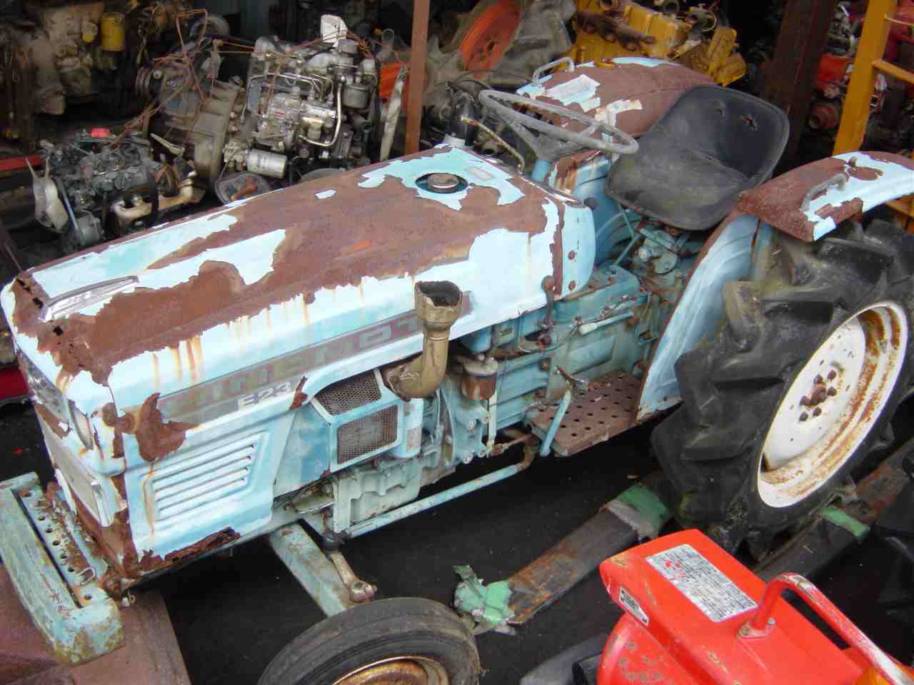

This one was missing front gears and had a cracked head and broken PTO housing

   / Looking to buy a Yanmar #42
I forgot to mention that this buyer is the high end "factory" in Vietnam, I have met him many times in the yards, the container this tractor went into was one of twenty, not one of them ran.

   / Looking to buy a Yanmar #43
I know I am crazy but this is the junk I buy for my customers. This tractor is the norm for us and is as it was, untouched straight out of the container. Did I mention it is the same price as the VN models at the dealer down the street.

   / Looking to buy a Yanmar #44
I'm confused, are these pics from the US or Japan? I had always heard tractors were shipped directly to Vietnam from Japan for reconditioning.
   / Looking to buy a Yanmar #45
All the junk tractors are pics from Japan. I am there one week every month and get a first hand look at what is being sold where. The pic of the 1610 is at my lot in the US.
The new trend I am seeing in Japan is the Vietnam buyers are no longer building a second floor in the containers. Normally a container has a upper floor built inside with metal or wood so you can get two levels of tractors. 8 to 10 on the bottom and 8 to 10 on top. Not building the upper deck saves a couple hundred dollars a container. The guy loading takes one tractor and sets it right on top of another tractor then shoves it in the container. The tractor above smashes the tractor below. Sometimes they stack the smaller tractors 3 high. I will get a picture next time I see it. It is hard to believe. I asked where they would get new hoods, fenders and dash panels to replace the smashed ones and the buyer said "we will pound them out". Nothing like slave labor!
