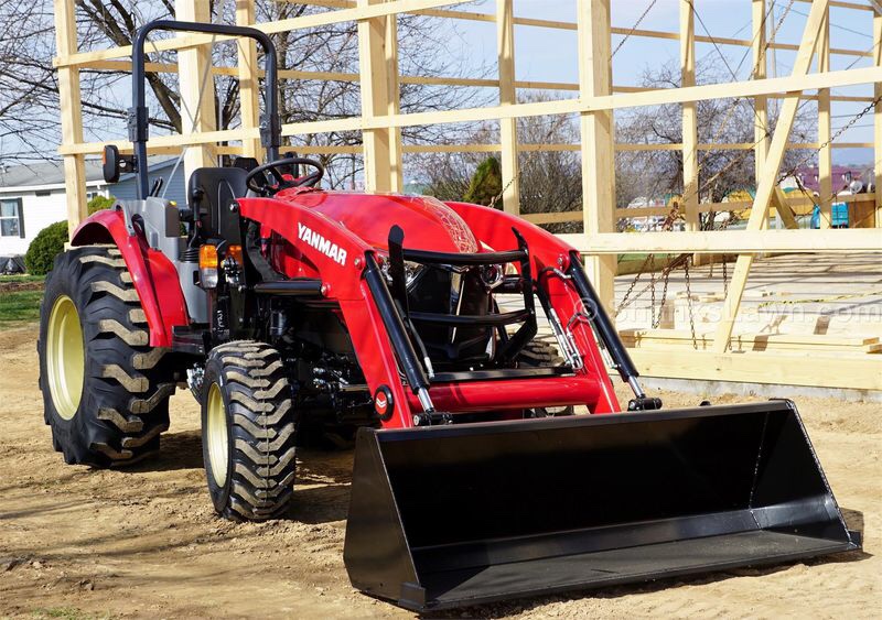

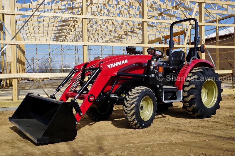

While you're shopping, you should check out the new Yanmar's too. Good looking tractors with high specs.
