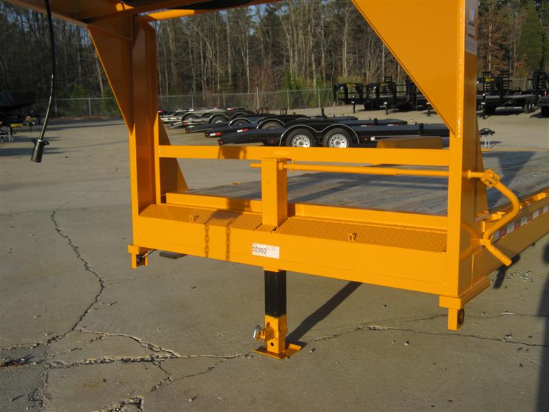

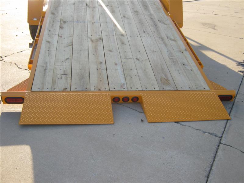

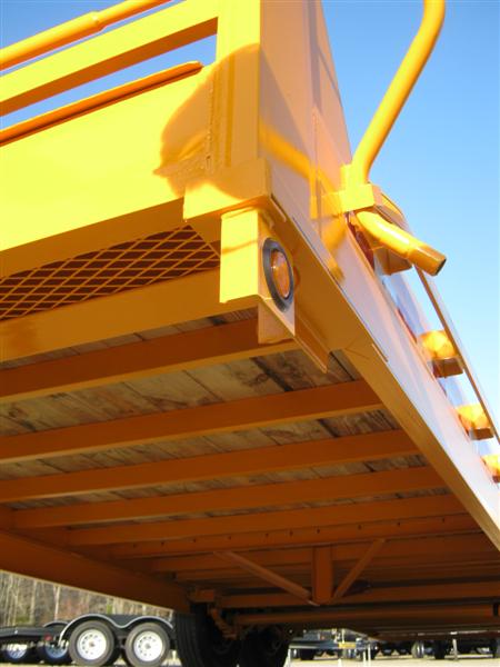

Gooseneck or tongue pull?
Low deck or deckover?
I like this one, but think that I want a deckover.
