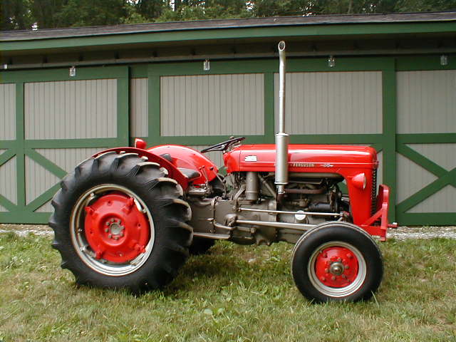

Massey 35 Deluxe
They are easy to work on, parts are readily available, plenty of hp for a 6ft bush hog and is easy on fuel. On the advice of 2 farmers I bought one. It was my first tractor and never let me down. I put a little money in it, used it for 6 years and 700 hrs and sold it at a profit. IMHO anything less than 30hp will be insufficient for your needs.
A diesel tractor is nice but as has already been mentioned they are more difficult to work on or to pay to have repaired.
Whatever you buy, especially in an older machine, be sure it has power steering.
