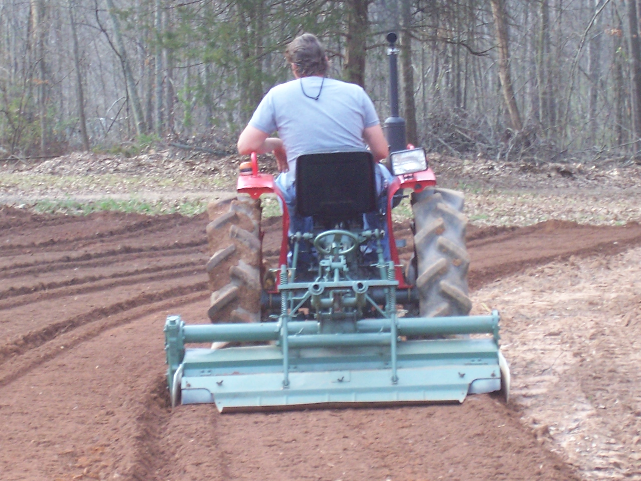

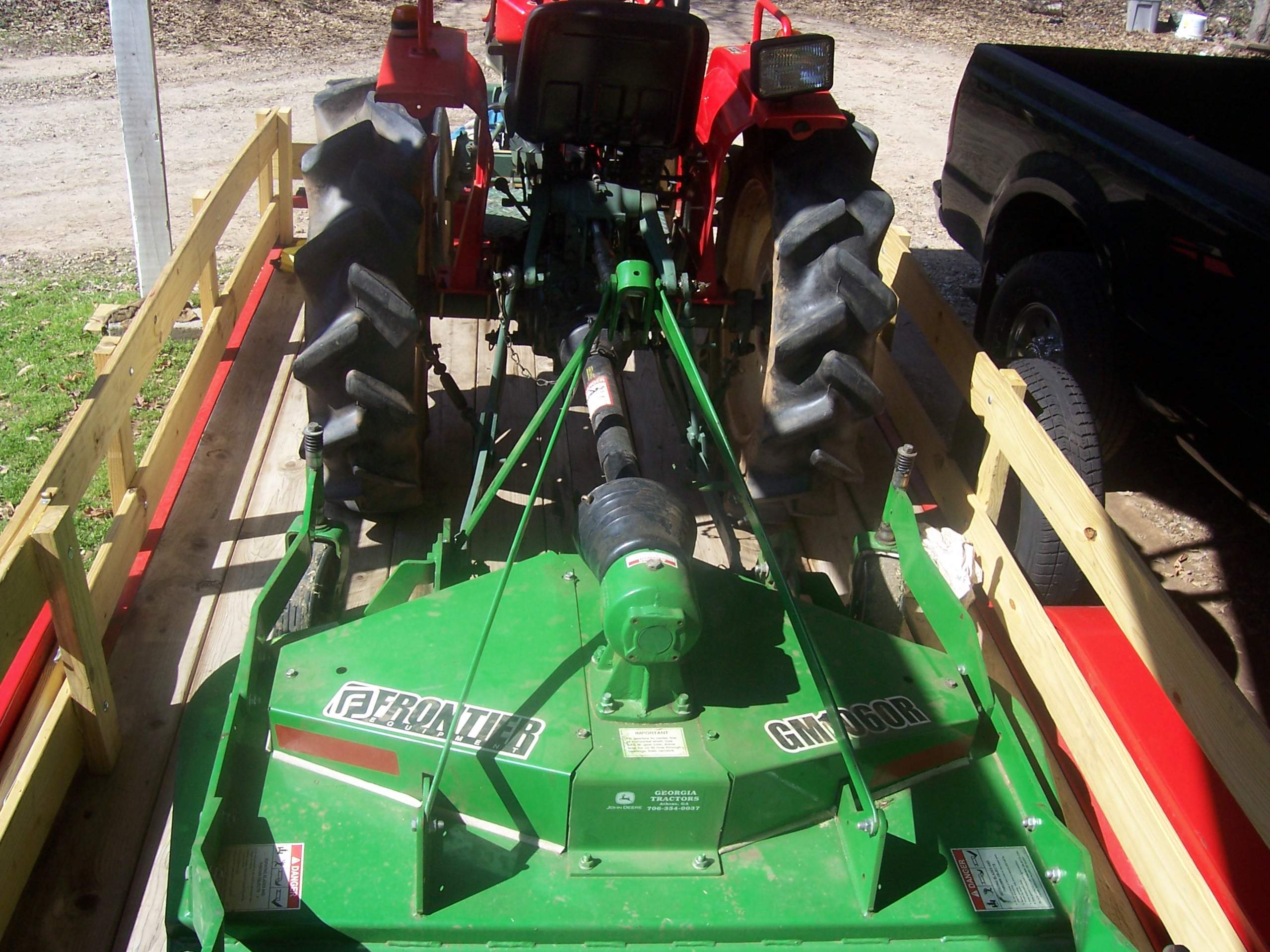

I'm in Ga. My YM2000 has been good after I made all the fairly minor repairs to it. I mainly use it to Mow and little tilling. If it was me I wouldn't put a FEL on it esp. for only 2 acres. You can Rent a large Bob cat in my area For 150.00 a day and then just use a box blade to finish up which I have a 4ft. I have a fel. on my Ford IMO there is just not enough Hp. for me to even think about one and needs on my Yanmar. And still would be touching up with a BB. Oh dang no ROP's and the tiller was from Fredricks which ended up not a very good deal at all.
Carey
