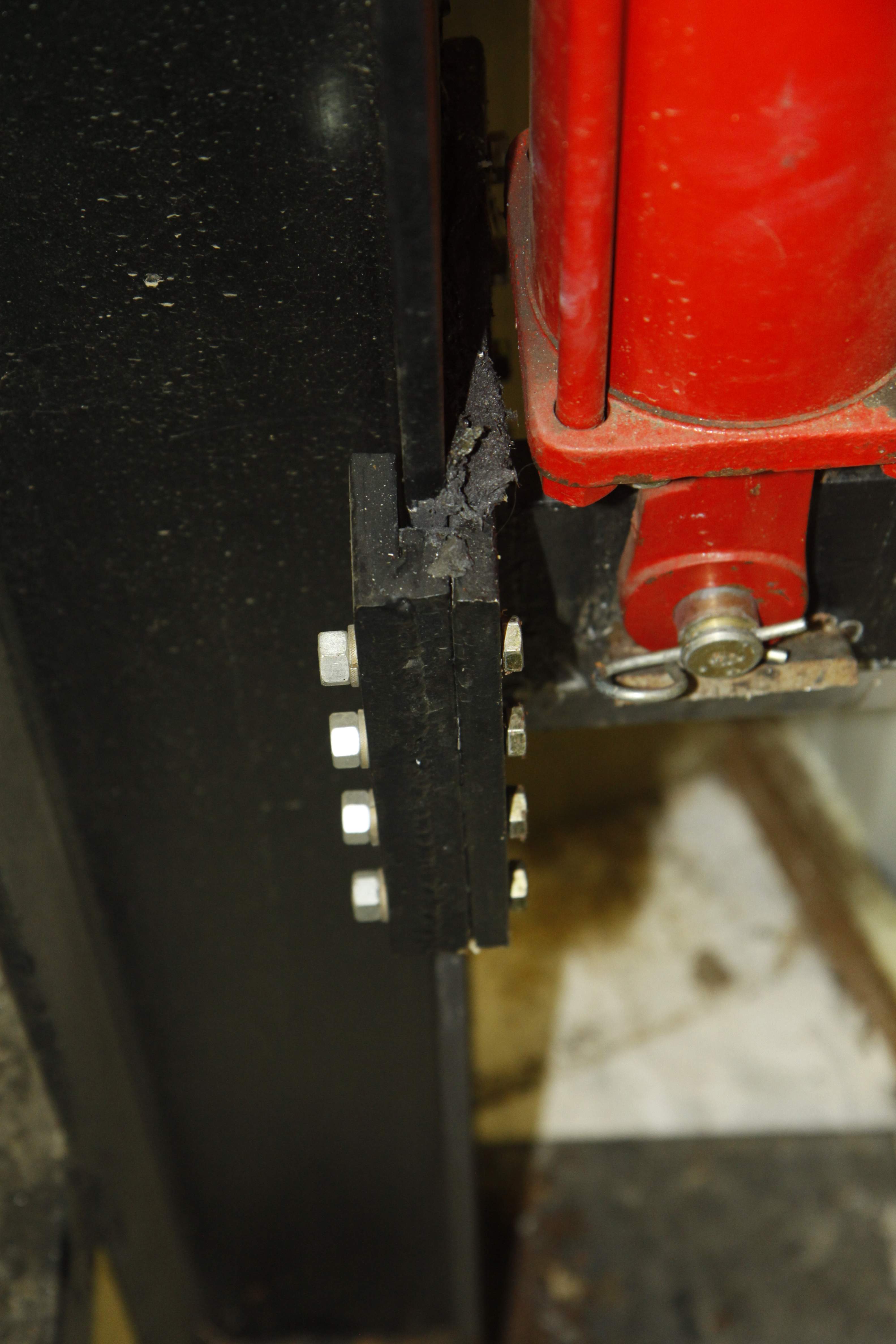

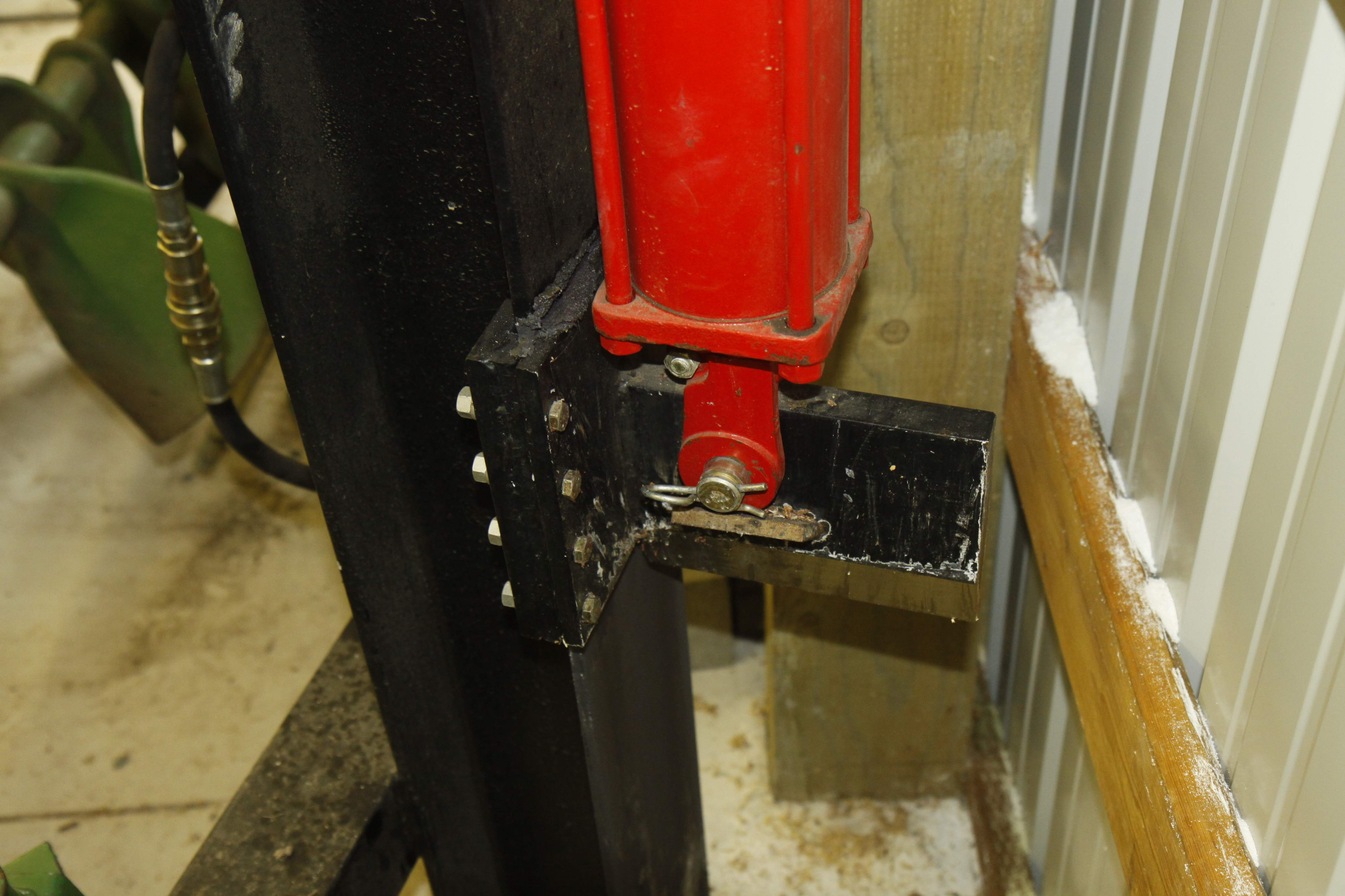

i simple added a little wedge to my splitter edge that really pushes the wood apart (and makes it miss the ram), it has speed up the cycle time, cause i don't have to drive the wedge as far into the wood, also i only retract it enuf to add the next log.
