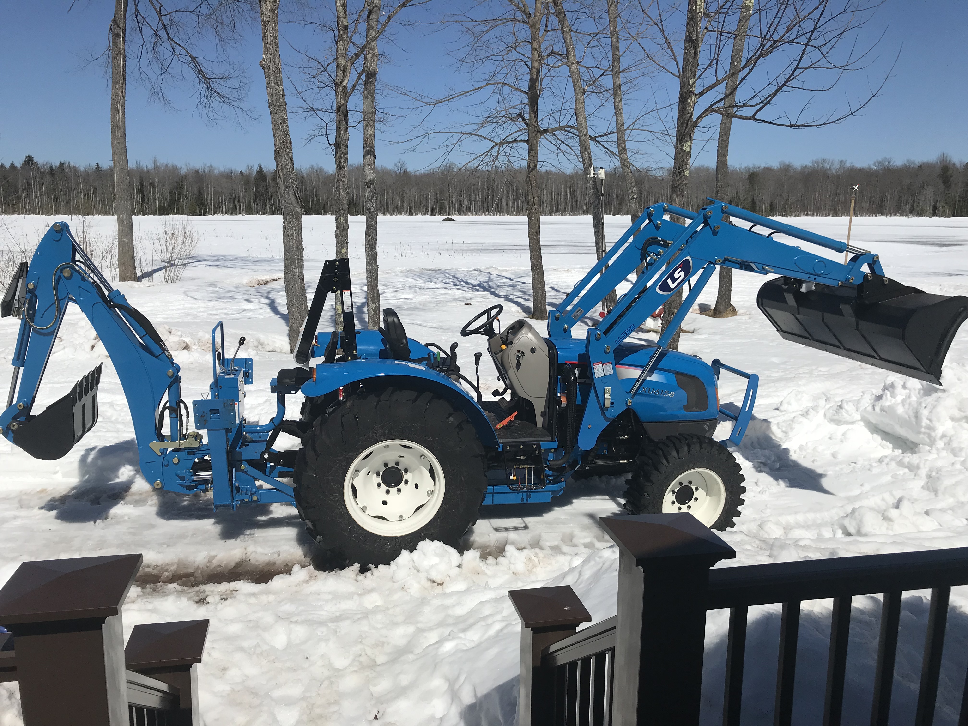

I know you said all the options you got on your, but I didn’t expect to get what you got because you bought the cab and the 6168CPS. I was trying to get as cheap a deal as possible for a loader/hoe, so my open station came with the third remote in the back with detent, it came with the lever in the back for the 3pt, it has switches for the pto cruise control and it came with the creeper gear. I’m super impressed with LS they really over delivered. All that with filled tires and 3 function loader hydraulics and extra bh bucket 12inch & 24inch delivered two hour from dealer for $38,150 cash.
I won’t get to play with the bh for a few weeks or so,. The picture of my tractor is taken in front of a Beaver Dam Pond frozen still, If you look close you can see the beaver huts where the rodents live. This tractor is here to ruin the beavers crappy little neighborhood, I’m going to redevelop his hood into a pond I can live with.
