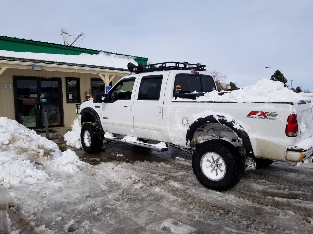

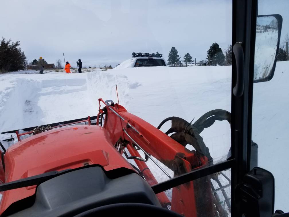

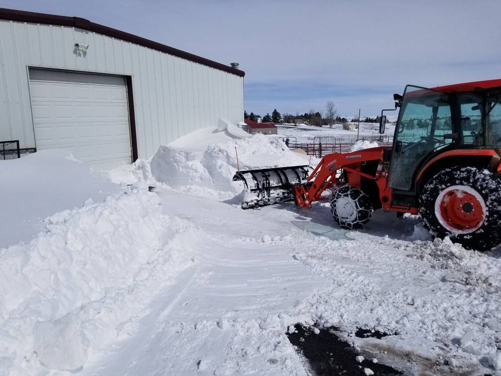

I had a L3200 for 3 years & am pushing that on the L4060 now.
There were a few snows the L3200 couldnt plow. I got a blower & still plowed 75% of the time, but could flip around & blow when needed.
My L4060 had no issues with a plow except pushing uphill with no chains until yesterday. Google Colorado bomb cyclone & see the before & after pictures attached. The L4060 was not half the tractor for the job.
Irionically my L3200 & blower might have stood a chance at working those 8' packed drifts with no room to work. I could claw through drifts a foot at a time back dragging. A L3200 could have done the same but slower. But plowing normal snow the L3200 tops out at a little over a foot where the L4060 will do up to 2' & wider.
Neighbors wanted tractor work & I spun up a side gig with the L3200. Mostly mowing, mostly up to finger sized brush, some 1' or so material. Pasture & field type stuff. It did fine. I wanted more power at times (for grass actually, it's eats more HP than brush suprisingly). But it did the job.
I got enough work I was able to justify upgrading to a cabbed machine with more bells & whistles. So I upgraded to the L4060HSTC after looking at all the brands. I still often feel underpowered. But that means you just mow a little slower & get the job done all the same. I want more power, but budget wise it was & still is the fight call instead of going to a bigger Grand L.
The L4701 might be a little odd, but not much & I wouldnt wory about it. It's a Kubota & resale if you care about that wont be that different than another Kubota.
Always remember that weight is what makes a tractor work (except for PTO tasks), HP just defines how fast it will get the job done. My L4060 would literally plow circles around the L3200 in 1' of snow despite only 8hp more & a worse power to weight ratio. Weight is traction & ballast to enable you to pull harder & lift heavier.20190314_133919.jpeg20190314_163700.jpeg20190314_123831.jpeg
