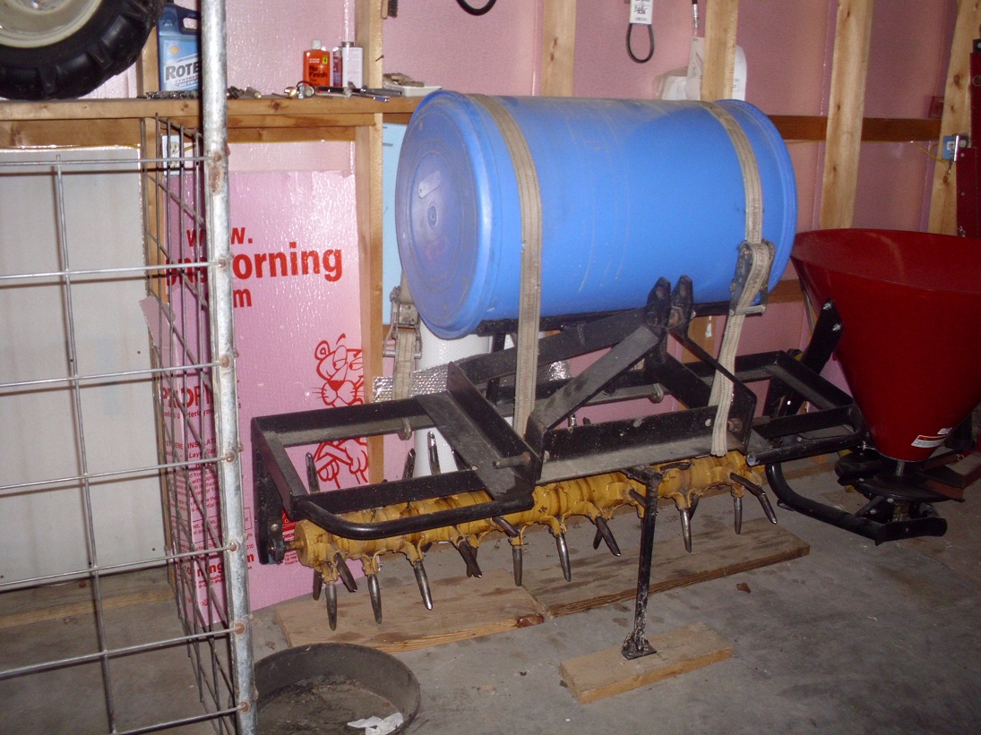

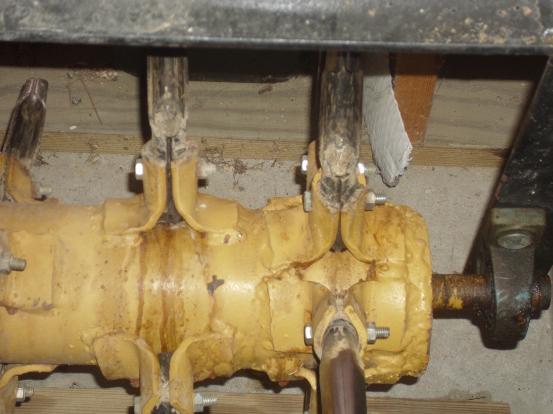

I can't help with the rocks, and I know what you mean, but one improvement I made to mine was to save up a bunch of Romex knockouts from electrical boxes. I held them over a vise and put a small dent in each one. I then welded one in each tine just below the pivot bolt. I put it on a slight angle. Now each plug slides on the knockout until it falls to the ground. Before the plugs would pack up into the top of the spoon where the bolt is. It would then do like it does with rocks and keep the plug from going all the way out each time. I also dip each tine in oil after each use. That way they are slick and polished for the next time, not all rusty. No smart remarks about too much time on my hands, it doesn't take but a few minutes to do.

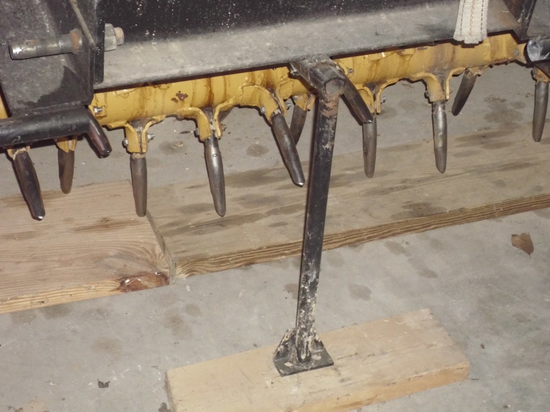

Well here is the whole package. I also put a framework so I could use a 50gal barrel as weight. I can adjust the weight easy that way, and drain it so it is easy to handle when done. I also put a foot on it . I used some scrap PTO shaft for a receiver and it comes off easy when in use. I also put the bent tube rails on the leading edge. The first tree I hit made those a good idea.
