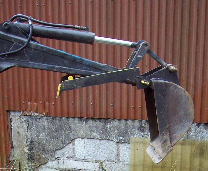

Here is a small on I made a few years ago.
