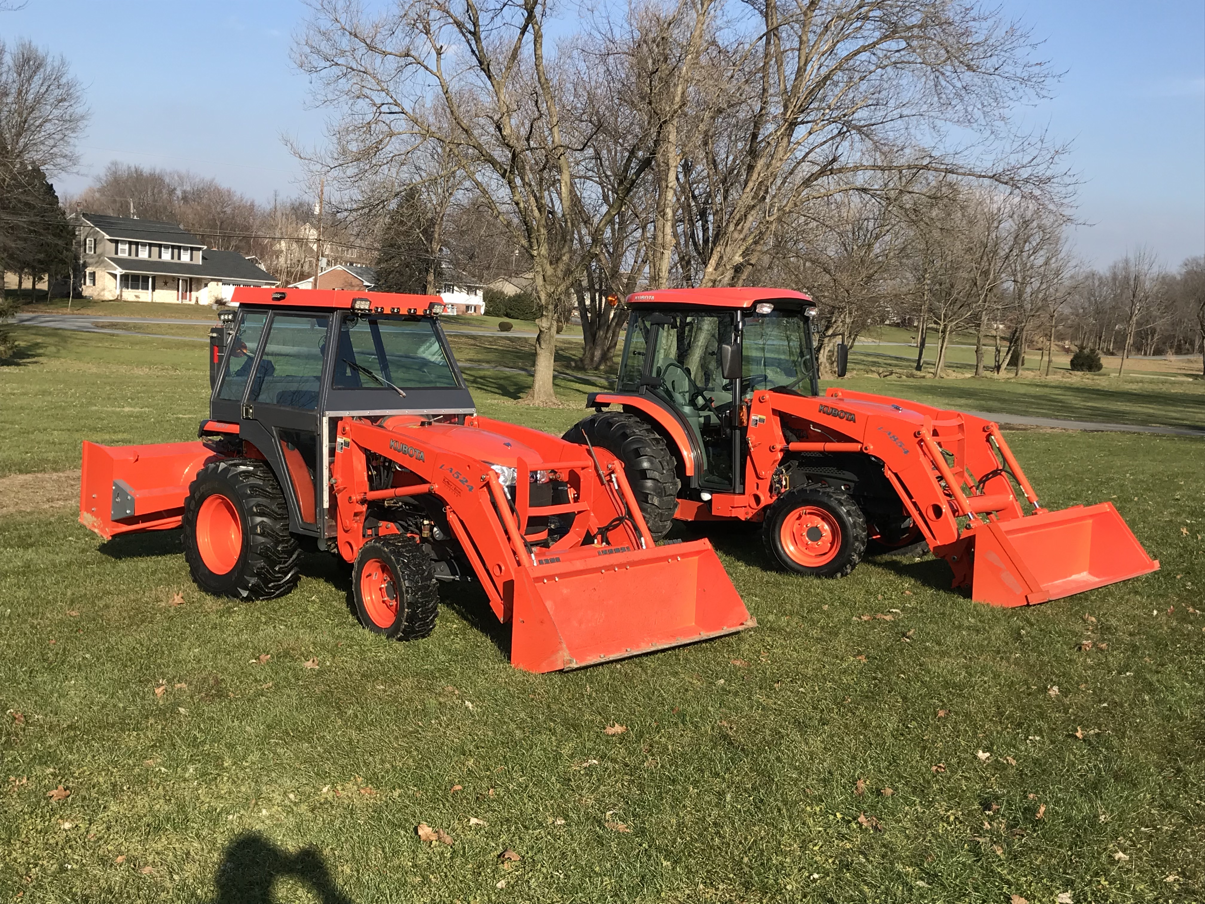

In December of 2018 I bought an L4240HSTC to replace the L3200HST. I had built a cab for the L3200, but decided it would be nice to have more HP, lift capacity and A/C. I was a little concerned about the increased size and ran both of them for nearly a year before selling the L3200. The position of the tractors in the picture below makes it appear there isn't much difference in size. with the L3200 in the forefront, it's a little like the pictures of hunters kneeling behind their trophies to make them look bigger than they are in real life:)
It gave me plenty of time to compare them. The bigger tractor handles better than the smaller one. It turns sharper and is way more comfortable to operate. See the post below.

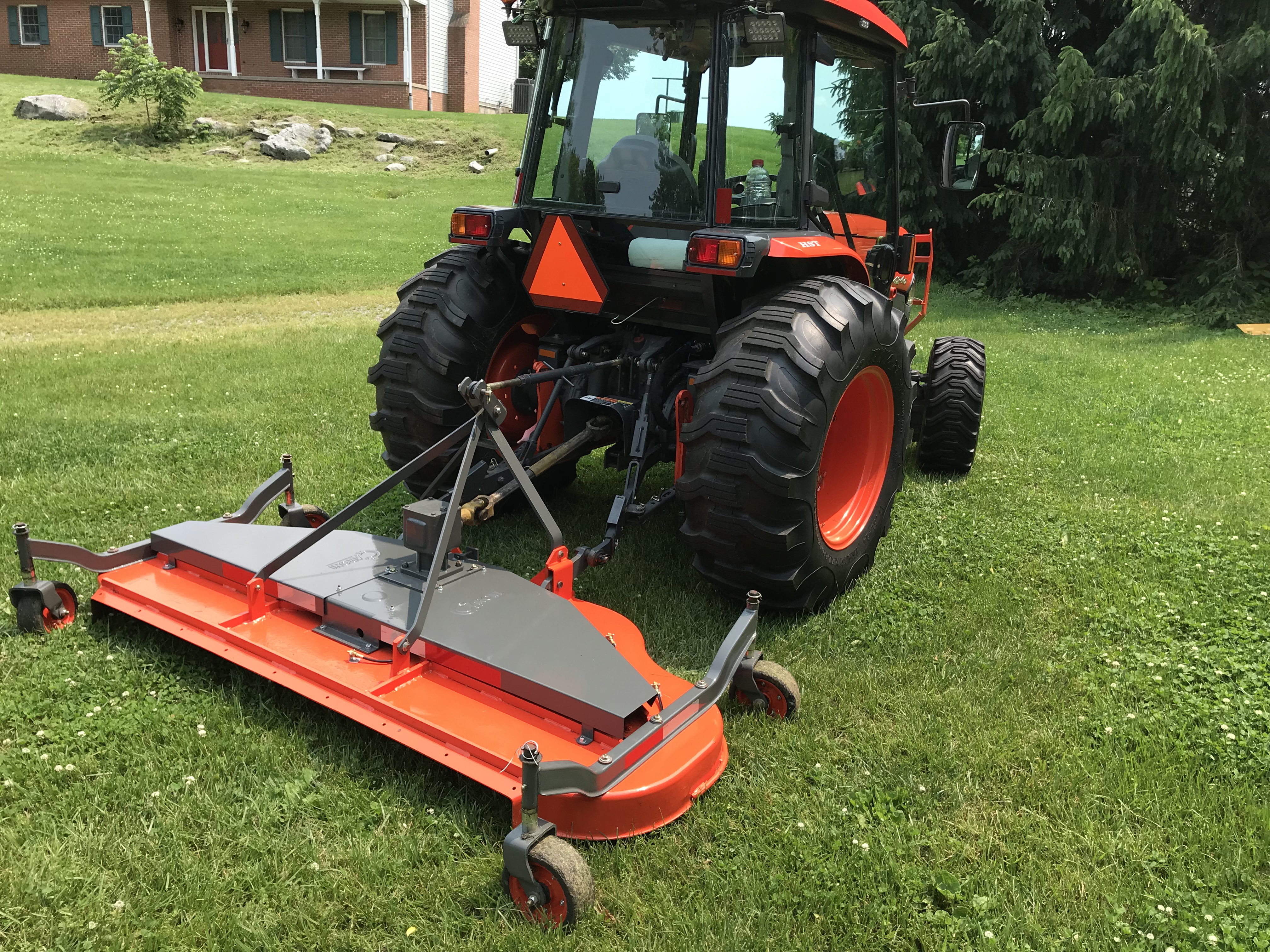

You're right about the HST+ trans. That is a great feature. I plowed snow yesterday and the capability of having the throttle work with the hydro pedal suits me for that. I road it to town to do our church parking lots. The HST+ lets me pull out from stops in H Turtle and bump it up into H Rabbit after it starts rolling.
For mowing I bump the throttle to whatever PTO speed does best at the time and then use the hydro pedal for motion. It easily runs a 90" RFM. The R4's don't tear up the yard.
