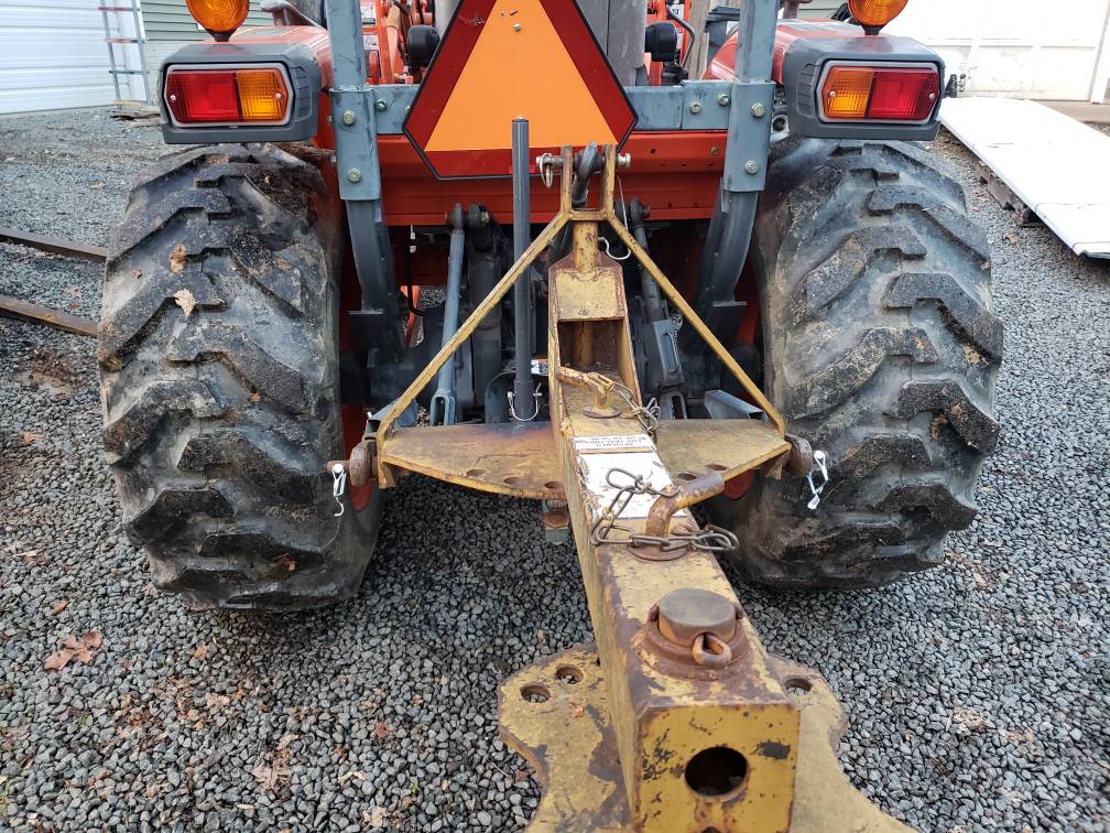

Got a chance to measure the tires again before grading the driveway, used boards against the tire to get a more accurate measurement (just for curiosity sake).

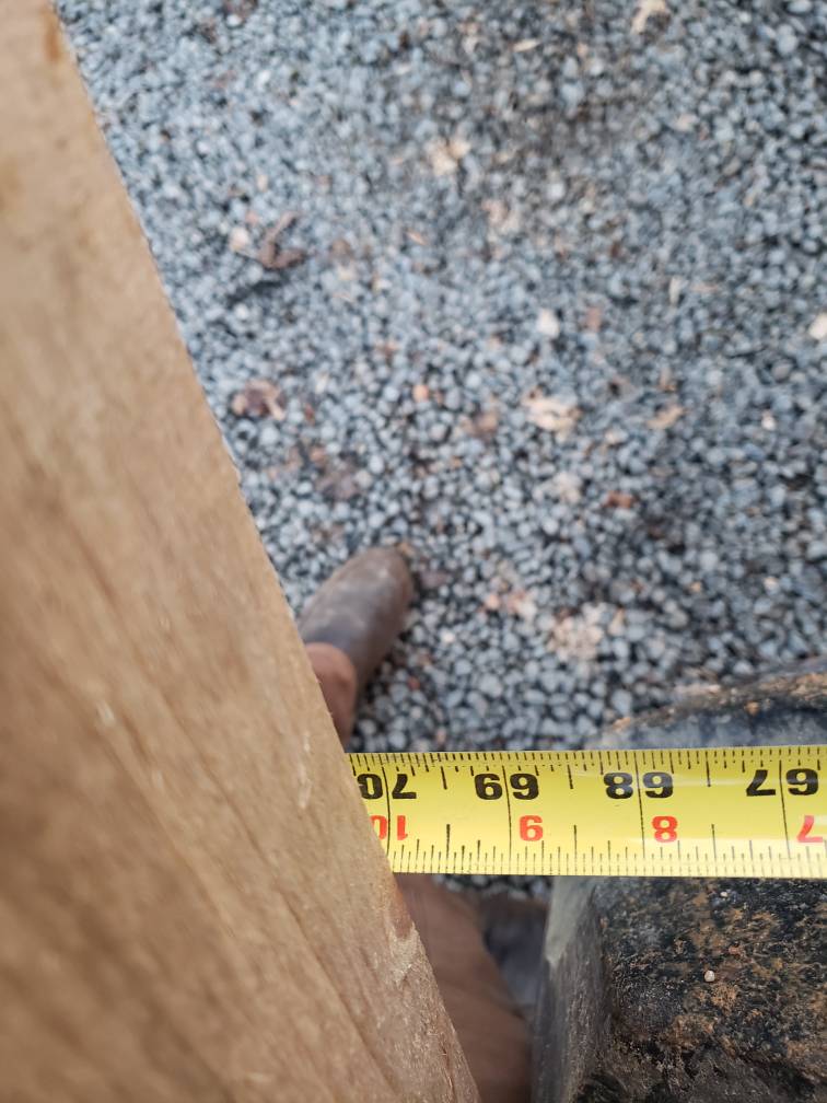

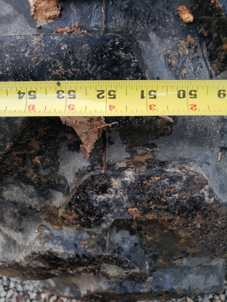

Centerline is ~52(using the mold line so may not be exactly accurate).20201228_165009.jpeg
There is definitely no extra room to go narrower and it matches the spec for centerline.20201228_164828.jpeg20201228_164835.jpeg

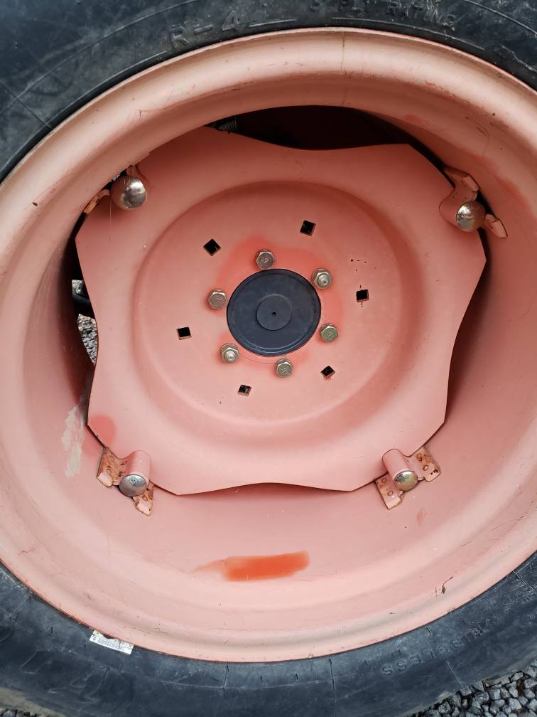

Wheel setting (don't mind the pink lol, I still need to clean them up!20201228_164900.jpeg
Hopefully this will help someone in the future, really wish you could find published info for this somewhere.
