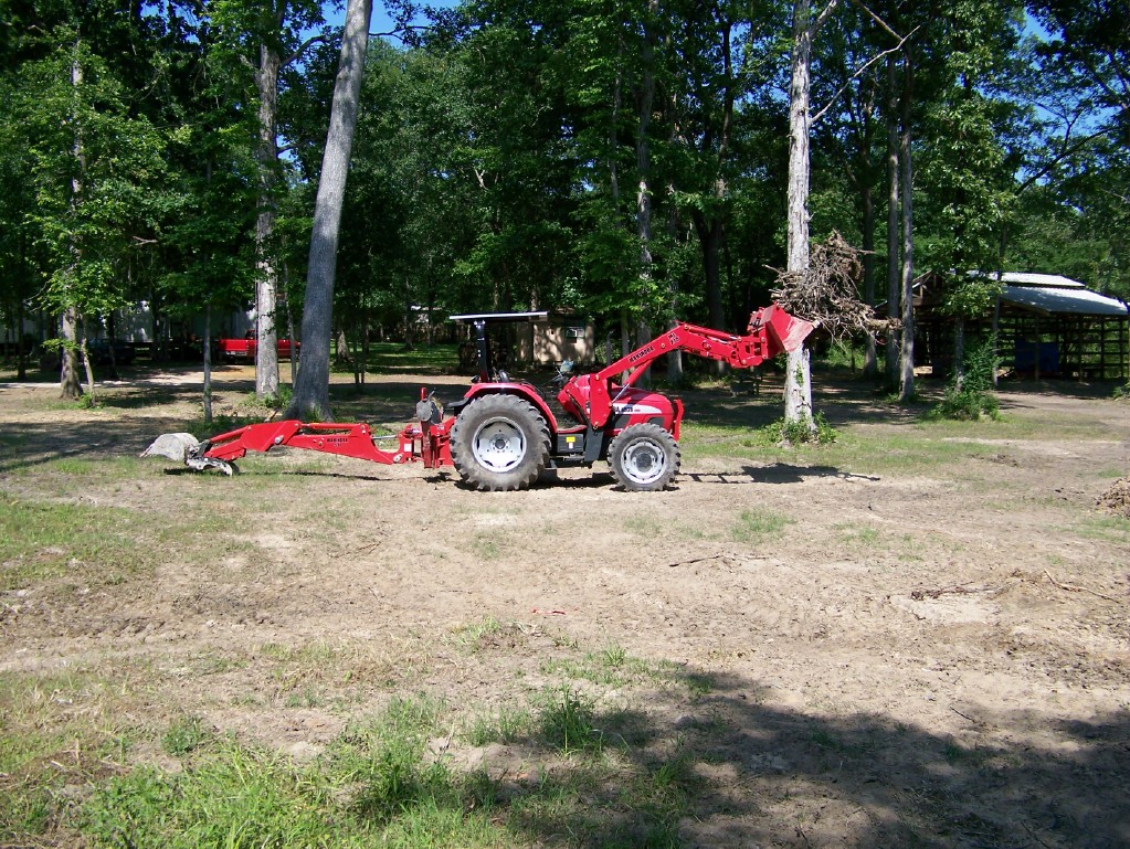

I suppose you would like that. :) By the way........my Mahindra 6520 FEL can lift your JD 790 11 feet. :D I don't have a JD 790 here in TEXAS to lift, but this photo should do. :rolleyes: I am sure the other guys here would like to hear from me from time to time with my 29 years of mechanical experience.

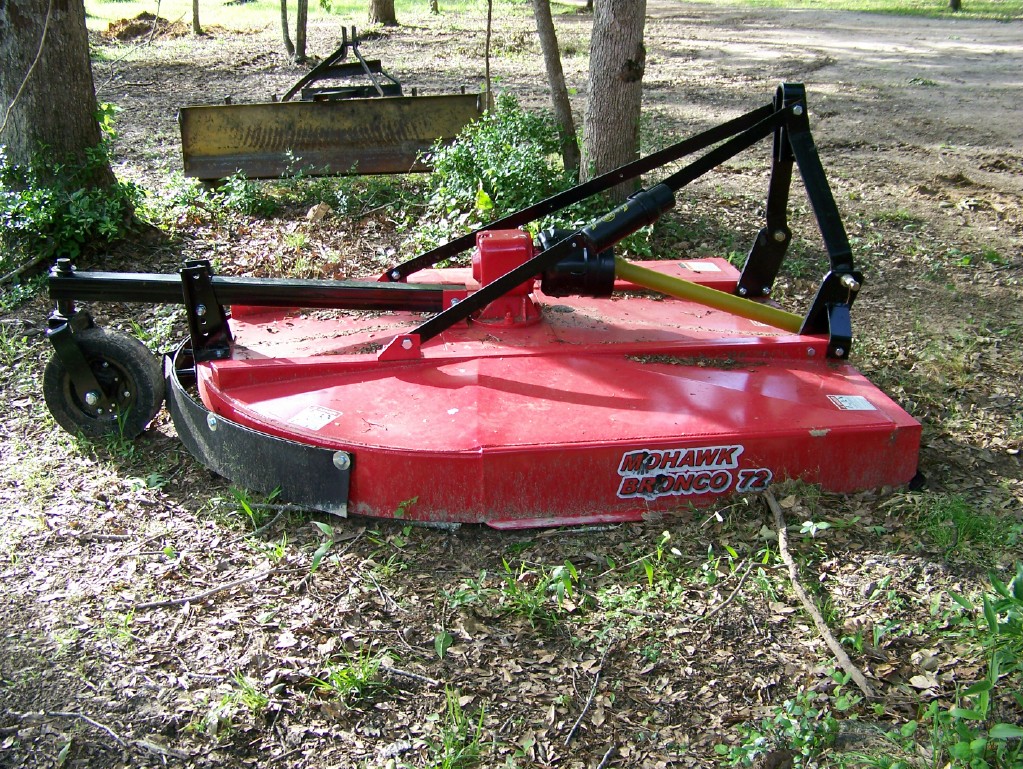

Now...talking about shooting equipment, my JD rotary cutter had a gearbox made in France :mad: and was leaking. You couldn't overhall it anymore, just replace it and the blade hub......at a cost of over $700. With all the cracks and large dings in it, it was ready for the scrap heap. It still mowed, but you needed a lot of gear oil to keep it going. The JD salesman suggested what he did to one gearbox on his batwing, inject grease into the gearbox. Never tried that. Photos below are my old JD cutter and my new Bronco cutter.

Well, I'm glad then you didn't shoot that old Deere mower after all. It looks better than mine! BTW, thanks for sharing that picture of your nice new Bronco cutter.
