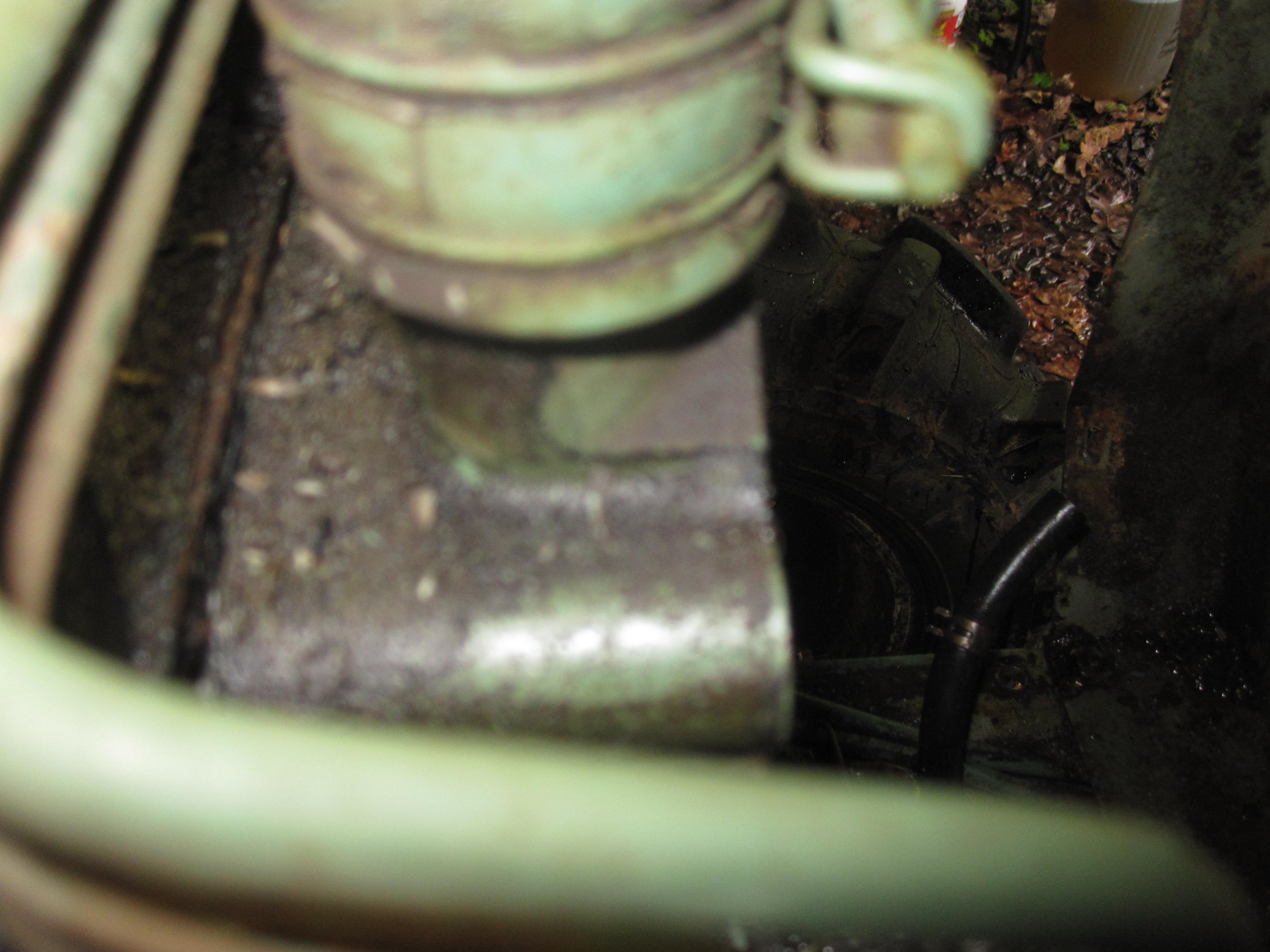

I ordered the amazon one, part number is the same as the most expensive one. Thanks everyone for your input :)
   / Loose pulley on YM1510d
#19
I am finally getting around to replacing this water pump. When I removed the old pump, there is a block behind it that pulled loose just a little. Do I need a gasket for that also? If so what gasket do I get? The seam in the picture is where it is loose, the pump mounts just below the hose clamp with long bolts going through the block.

You need to be careful with the Chineseum parts as they don't always fit correctly. I know someone that bought one for their Kubota (not me) and the impeller was sticking out too far and ate into the timing cover under the impeller and that was an expensive ordeal. if you get one, just don't bolt it up but makes sure it fits correctly before buttoning it up and filling it with coolant. There is not much clearance between the impeller and the timing cover. The Chinese are good at copying stuff but they don't always get the clearances correct. That retailer sells a lot of Chineseum after market parts so beware.
