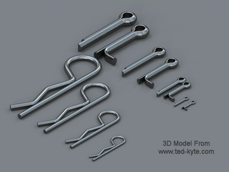

This is now the second time I have lost a cotter pin off the back of my tractor. The first time was during some rough bush-hogging. The cotter pin got pulled out and I lost the retention pin that holds one of my sway bars on. Now, I noticed that the cotter pin on the retention pin that holds my sway bar to my lift arm has been pulled, although thankfully, I have not lost the retention pin because it is flat on one side and inserted from the top. All of the pins I have lost are spring-type cotter pins. I am thinking I will replace them all with split-pin type, because it seems like they are nearly impossible to pull out accidentally. If I ever need to take apart my 3ph, the split-type will be a bit harder to pull out, but I don't anticipate taking apart my 3ph very often, and I'm darn tired of losing things off it.
These are the pins I'm referring to. I have heard both of these referred to as "cotter pins". The ones on the left are "spring-type" and the ones on the right are "split-type".
   / Losing pins off the back of the tractor #10
The ones on the bottom left are normally called "hitch pin clips" They are used on the top link of attachment pins.
Using them on lower links or anywhere near the ground is asking to have them pulled out by weeds. They need to be sized for the pin they hold, and even then are very subject to being too loose. They get bent.
Not my favorite type of fastener....
Go to tractor supply.com and look at the various pins available under "hitch pins"
You will find what you need there.

My tractor also has the hitch pin clips on top and bottom of the lift. What I do is push them all the way through, where the round part is and I haven`t lost any more of them. This method is simple and it works.

Locking lynch pins are just about the only things I use

It's true, but for the price of 1 locking lynch pin, I can buy 100 split cotter pins. Meh. It's not a perfect comparison, because I only need about six locking lynch pins. More fundamentally, I already bought split cotter pins and put them in, so I now have to rationalize that was the best thing to do. :D

Wait until something gets loose and bends up because you are pulling or pushing with only one side of the hitch. Sometimes to save money you have to spend it first. Now pry that wallet open and get a ten dollar bill out and buy a handfull of lynch pins in sizes for all your pins.:laughing:

I just paid $0.79 for 2 lynch pins sized for the lower arms to the implement.

All joking about money aside, I don't actually understand what you mean. The problem with the spring-type pins is obvious: weeds pull them out. But the split-type pins seem pretty secure to me. How are they going to come out?
   / Losing pins off the back of the tractor #20
They'll still pull out.. They just require more force before they do. Also, the bent ends of the pins can get caught and "straightened", making them fall out.
