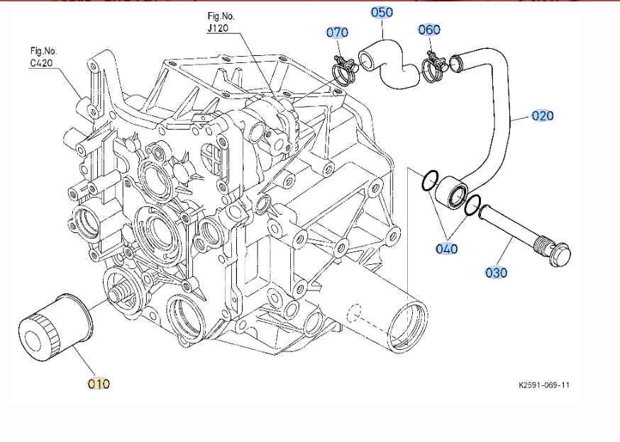

So I have a bx 2200 and when it gets warm it losses all hydraulic, won't lift, or drive. I am using tractor supply hyd fluid. Is it the fluid or do you think I have a hyd pump issue. I had some debris in the previous oil so I changed it and the filter, just replaced it with the tractor supply oil.

First question. Does the steering quit when this happens? Was this issue present BEFORE the fluid and filter change? I'm no authority on BX tractors but somehow I doubt the TSC fluid is the problem.
   / Loss of hydraulic #5
I agree with Harry in Ky. Highly unlikely the TSC fluid is the issue. If it was doing this before you changed it then you didn't correct the problem. When you changed the fluid, filter, and had debris what do you mean by debris? Metal particles? If you had metal as in more than a few little flecks then you may have serious issues. Did you happen to take photos of the debris? If you have the filter still you might cut it open so we can see what sort of contamination it has in it. I don't know the system so I won't try to troubleshoot further than that. When fluid is cold things will always function better than when warm and when it warms up it bypasses much easier. If you have internal bypassing going on the fluid will get hot quickly. Have you noticed that?

The BX models use a single pump with priority flow control to provide flow for steering which then is also charge flow for the HST. Excess flow goes to implement. If losing ability to drive it certainly points towards a pump flow concern. First thing I would suggest is checking system pressure on steering and or implement circuit. Check with both cold oil and when warmed up. If memory is correct the main system relief is also located before the priority valve.

I blew a hyd hose and replaced it, then my father in law said he had some hyd fluid in a 5 gal bucket that I could put in there, well it was used which I didn't know it was, had all sorts of stuff in it. I ran it for about 20 minutes and that's when all this happened. So I changed the hyd fluid and filter with the tsc fluid and still having the issue after 15 minutes of running, it will not steer barely drives and won't pick up the loader at all
