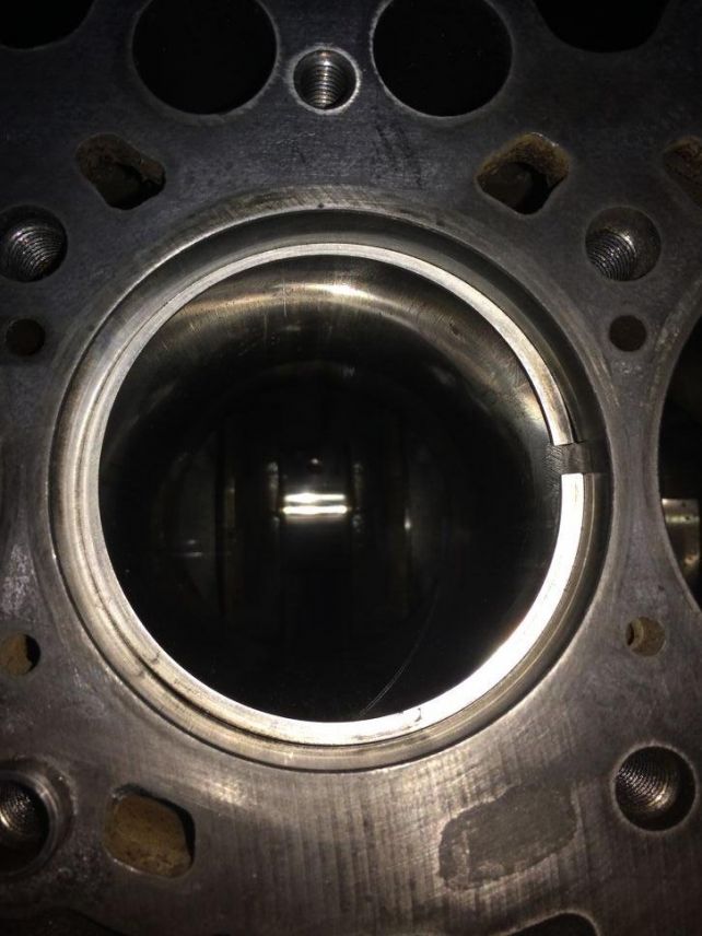

I have hadsimilar issues with mine, (just joined today) and I am currently rebuilding mine. I also had issues like jrsavoie and #2 going south. It had 140 psi, then with some oil it went to 190psi. I had a tough time starting the engine, alomst 10 minutes of on and off cranking. So, I got an itch and tore into it. Heres what I found, #2 had significant wear on the wall, (enought to have to go to .025 oversized) and had a lot of blowby.
Please be mindful of these little engins. If your having a tough time with starting, idle or power, do a compression check and if one is low, pull the head. Im telling you that if you prolong it, you could be in my shoes. Im looking at a $600 bill for just 3 oversized pistons and rings. Thats not including the gasket kit, new connecting rod bearings and mains.
