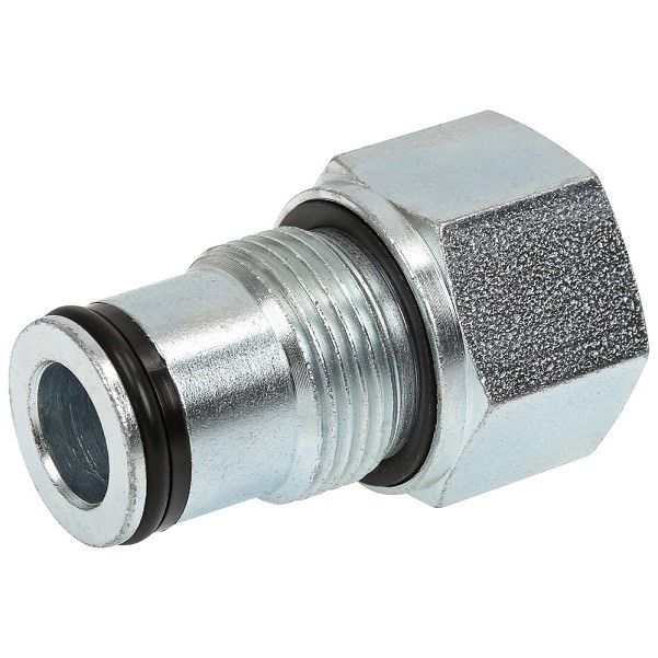

Power Beyond is not expensive. It's just a special fitting that goes in the "N" port and a couple hoses that will make that valve connected properly without the risk of getting damaged.
These control valves are not designed to have full system pressure on the tank passages inside the valve and using the Tank port to feed the rest of the circuit, can and will eventually damage the control valve, usually in the form of a cracked housing or blown o-rings.
This is the power beyond fitting that goes in the "N" port. Without this fitting, the N and T ports are connected internally. With the fitting, it will get fluid directly from the P In port, as long as the lever are in neutral, to feed the rest of the circuit.
