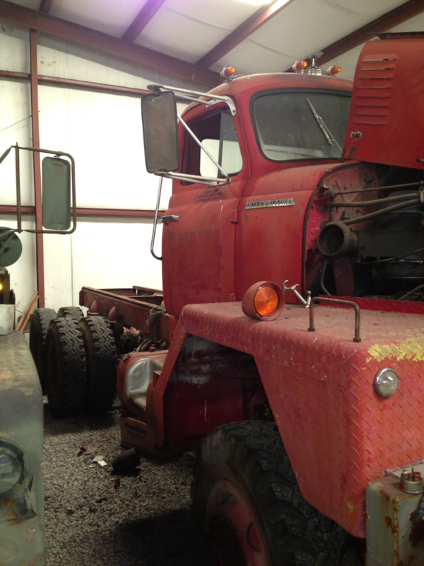

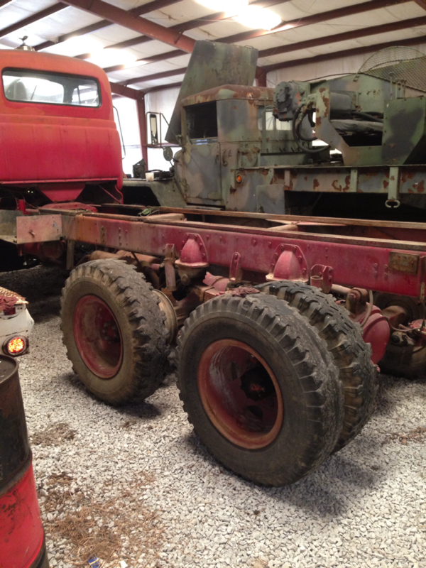

My Grandpa has a old international forestry fire truck. It has a 5 speed transmission with a two speed transfer case. It is gas, and capable of hauling a 3,000 gallon water tank plus the pumps and other gear. I know the milage of a gas truck this size is terrible, but it will take a Long time to make up the purchase price difference being parked 320 days a year. image-3035708406.jpg image-4290973408.jpg
