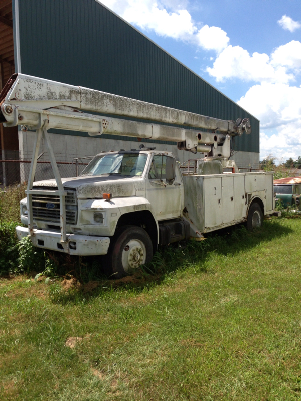

I have a Ford F-800 with a good ole diesel and air brakes. I don't remember what I paid, but it was way less then $10,000. image-3347800570.jpg

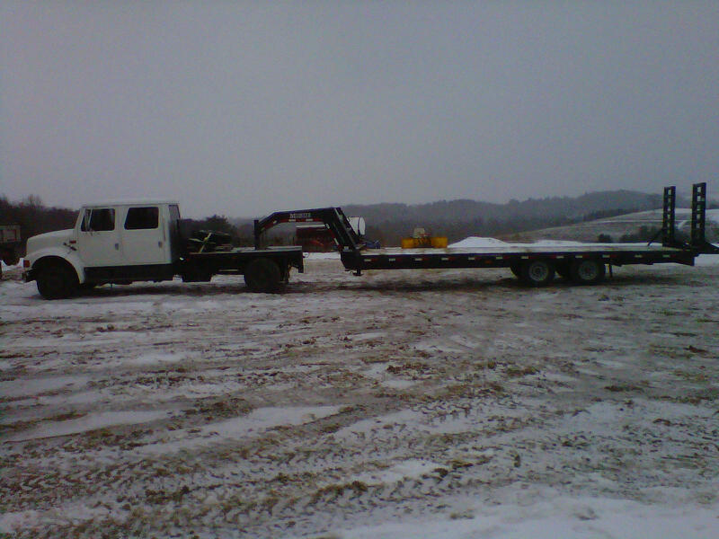

Get a diesel with under 300k. Run away from the Gas motors unless you don't mind 4mpg. As long as the truck is in good shape and not leaking fluids it should serve your needs well. I would try and find something setup for your needs from the get go unless you want to customize things with time and money. Again, I would be looking at a dt466 or dt530 if at all possible with higher hp motors being more preferable. 215 hp isn't going anywhere very fast. I have a dt530 with 275hp and I could use some ponies climbing the mountains on the interstate. Don't get me wrong, I get there and get there safely, sometimes it would be nice to not be in the slow lane with the semis! I would also not shy away from the Allison MD3060 trans but I would steer clear of any of the MT Allisons. I would look for the trucks with the engine retarder and the exhaust brake if at all possible. I found out the exhaust brake on my truck was long ago disconnected and I'm working on getting that back up and running.
My trailer puller!
