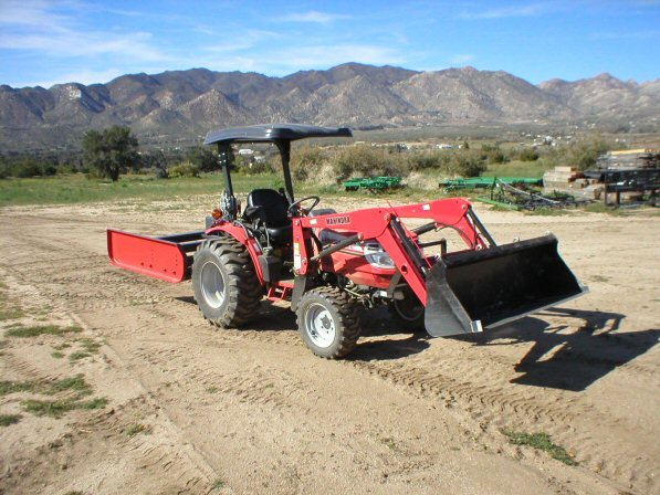

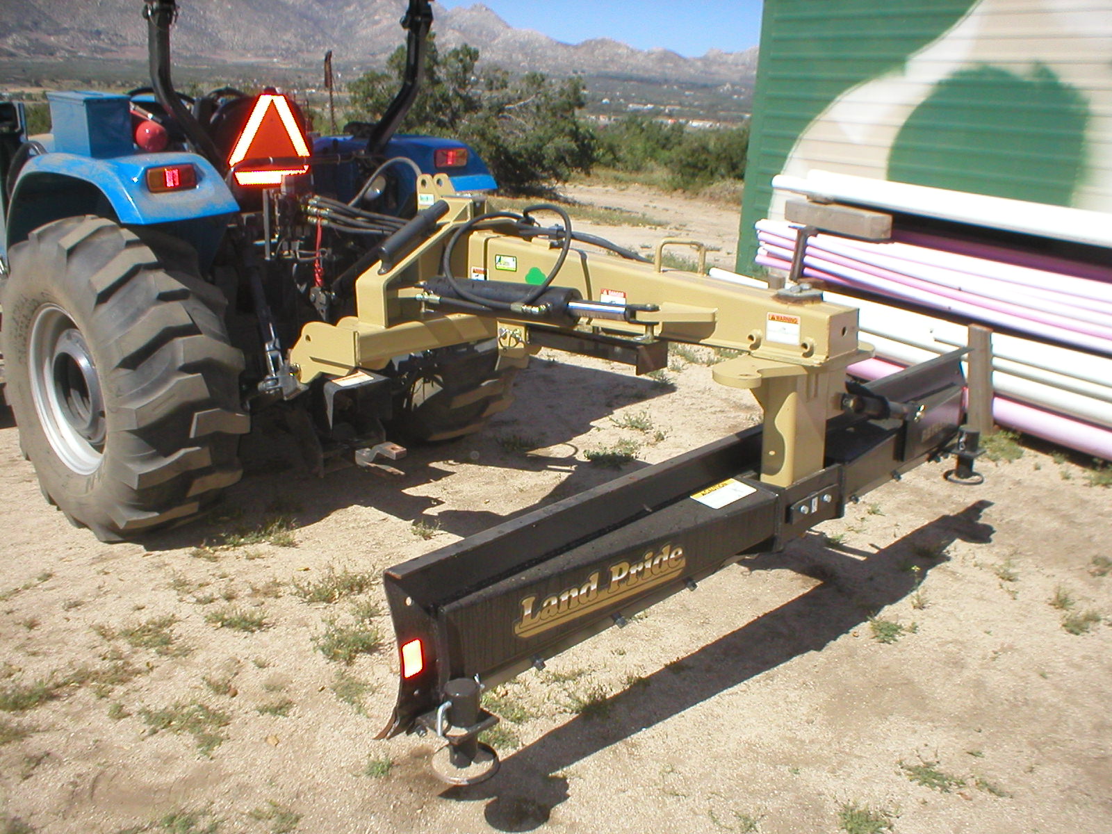

And, Brian, what width blade do you recommend........
As I mentioned in post #6, for the rear blade, a 7 footer and either the Mahindra offset series, or preferable the heavy duty series. You run that 7 footer at a 35* angle and it is only about 66" wide.
One of these days I will get a Land Pride RBT3584 for my Mahindra 3215. Believe it or not, sometimes it would be nicer to use a smaller tractor & blade other than my 7520 with the RBT45108. ;)
