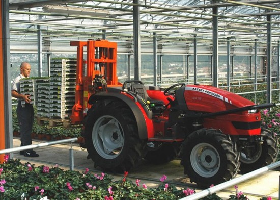

here is a pic of a Massey ferguson, the previous was a deutz its the same model
and nearly the same as a Nh tce
