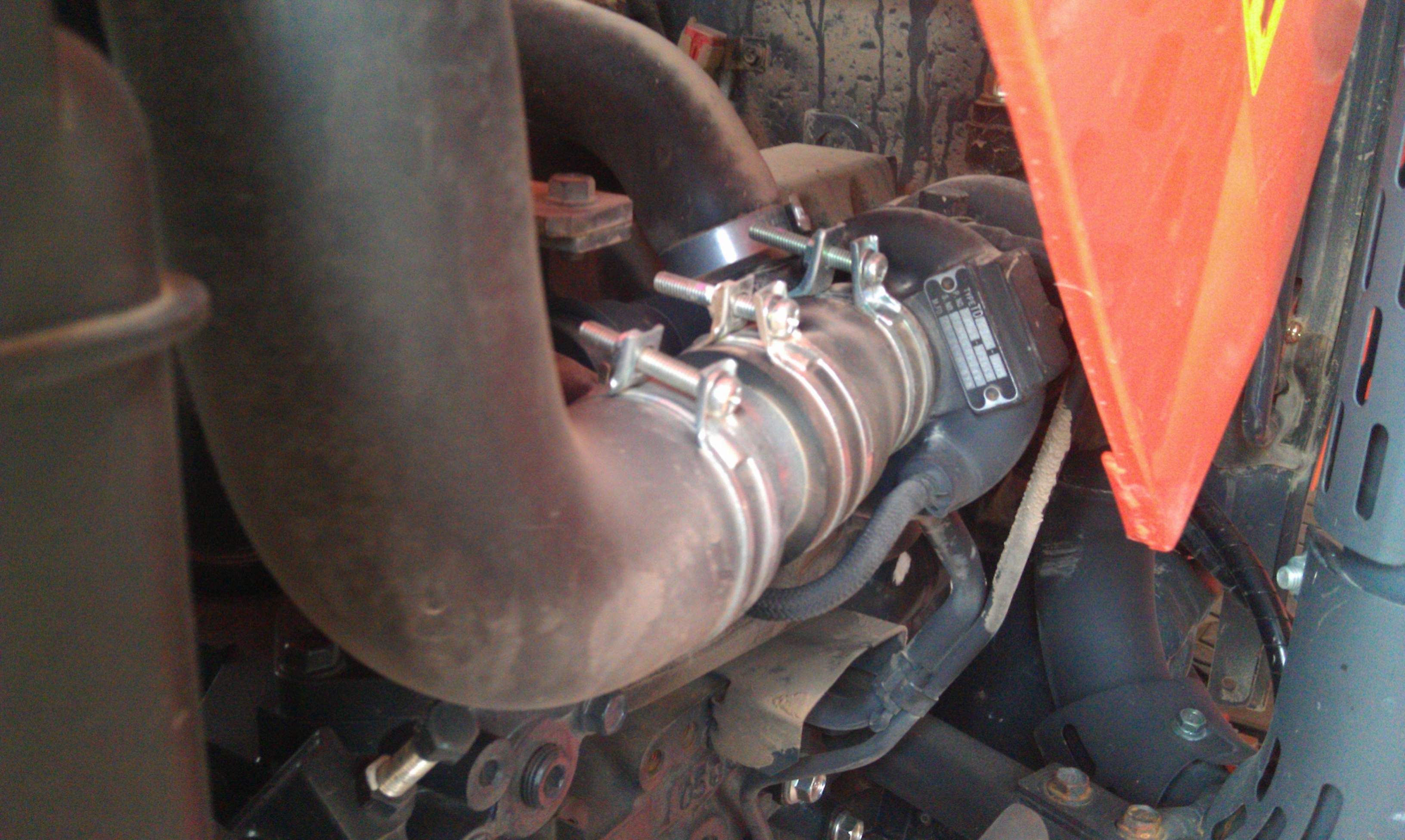

This might sound crazy....but I read that the M7040 are turbocharged and my manual says "check turbocharger every 3000hours" but I dont have any turbocharger on my M7040....The tractor are from 2009.
:confused2:
   / Loud squeeeek noice on my new M7040...
#16
Yepp no turbo! Well it seems to work very well without... strong and responsive on the throttle. But I miss the turbo wissle.
   / Loud squeeeek noice on my new M7040... #17
Not sure of the years, but that tractor was made without a turbo to meet the tier II emissions standards. It got the turbo to meet the interim tier IV.
