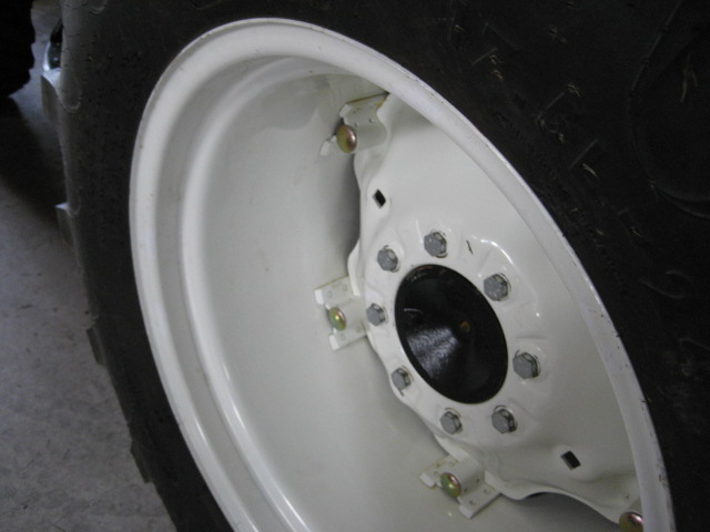

Mad Dog- Those look like the rims that come with the ags on a JD. Thats what I was hoping for but the R4 rims are solid and wider than the ag rims. They only have about 1" more clearance if you reverse them, which I have, but this makes the valve stem very awkward to get at. Even with the stem guard I still managed to rip out a stem one day in the bush while building a trail for a guy .Had to make a quick trip to the trailer before it lost all the air and left me stranded. Lucky I could hook the FEL under the trailer at an angle and lift the bad wheel into the air to remove it. Then we winched it onto another smaller trailer and took it to the tire shop. Didn't hardly loose any of the WWAF even....

Looks like you need to get some NH wheels & paint the rims yeller. :p I have about 20" between the narrowest & widest settings.

MadDogDriver, the R4 adjustable wheel/rims on my JD 4320 Cab are exactly like the ones you have in the picture. The only difference is mine have JD yellow factory paint and were on the tractor when I bought it new. I currently have them set at the widest setting which is too wide for my trailer. I'm going to bring them in a notch and it should load up without a problem. I have done everything with the R4's that I did with the R1 tires on my old tractor. The only thing about the R4's I don't like is that they flatten out the tall grass when bush hogging more than the R1's. There are several tractors with the adjustable wheels/rims at my local JD Dealer right now. R4's work fine for me as I have FWD. If I only had 2WD I'd have R1's for sure.
