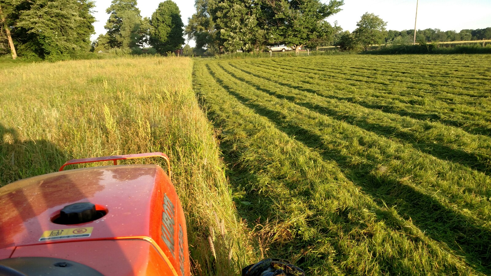

Just realized this pic I posted dont really do it justice due to the angle. I should have got off and took a side shot.
the grass was ~36" high, and at times you could see the tops (seed pods or whatever you want to call em) over top of the grill guard. And in that pic the cut quality dont look as clean as in person. Looks kinda ratty in the pic, but it was a nice cut. All the stuff that almost looks like it didnt cut even, is just the clippings scattered around.
Mower is set to 4-4.5" cut height in the front, measured off level concrete floor. Bout 1.5" higher in back.
