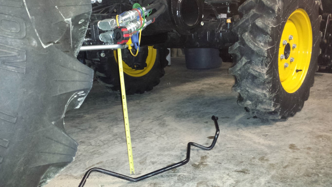

Problem is the loader hydraulic hose connections are mounted hanging under the tractor on the right side just begging to be torn up by limbs or stumps and twigs and what ever else I am always running over. I do a lot of bush hogging where I am knocking down 10-15 year growth in wooded areas on rolling terrain and those couplings and hoses are in the absolute worst place. The hydraulic filter is exposed along with some other hydraulic tubing that could be protected somehow but I don't have time to research before I have to jump on the deal I have found.

The ground clearance of the LX is 15 inches. I measured the ground clearance where the loader valve is mounted and the clearance there is 18.5 inches.
If you really like the tractor, and you're getting offered a great deal on it, just pay a fabrication shop to make you up some skid plates. There's a few good threads here on TBN about making skid plates for other tractors. Also, that spot would also be a good place to add another step so you don't have to keep walking over to the other side when you want to climb up into the operator's seat. The new step could be worked into the skid plate design.

thanks. 18" clearance doesn't sound so scary. They were just hanging down there so much below everything else my mental picture is that they were lower than anything else. Now that I know I like the rest of the tractor I need to go back and take a real look at the coupling location again.
Definitely saw that I want a step on the right side. The FEL controls are well clear of the path. Those low slung hoses were the first thing that caught my eye when I moved up close to the tractor. But I got so absorbed in everything else and simply liking everything else about the tractor I did not want to even think about the low slung hoses. I am telling you right now, Yanmar has a really nice tractor there.
But I did not crawl under there and look things over to asses what might be possibilities for dealing with the hoses and exposed filter. Wish I had taken a pictures so I could sit here and think about it. I am going over there again tomorrow and look it over a bit closer. If anyone has a link or clue for searching the skid plate threads, please chime in.
What I want to do tomorrow is see if there is a way to simply mount the hoses up higher on the FEL structure somewhere. that would leave only the simpler problem of protecting the hydraulic filter.

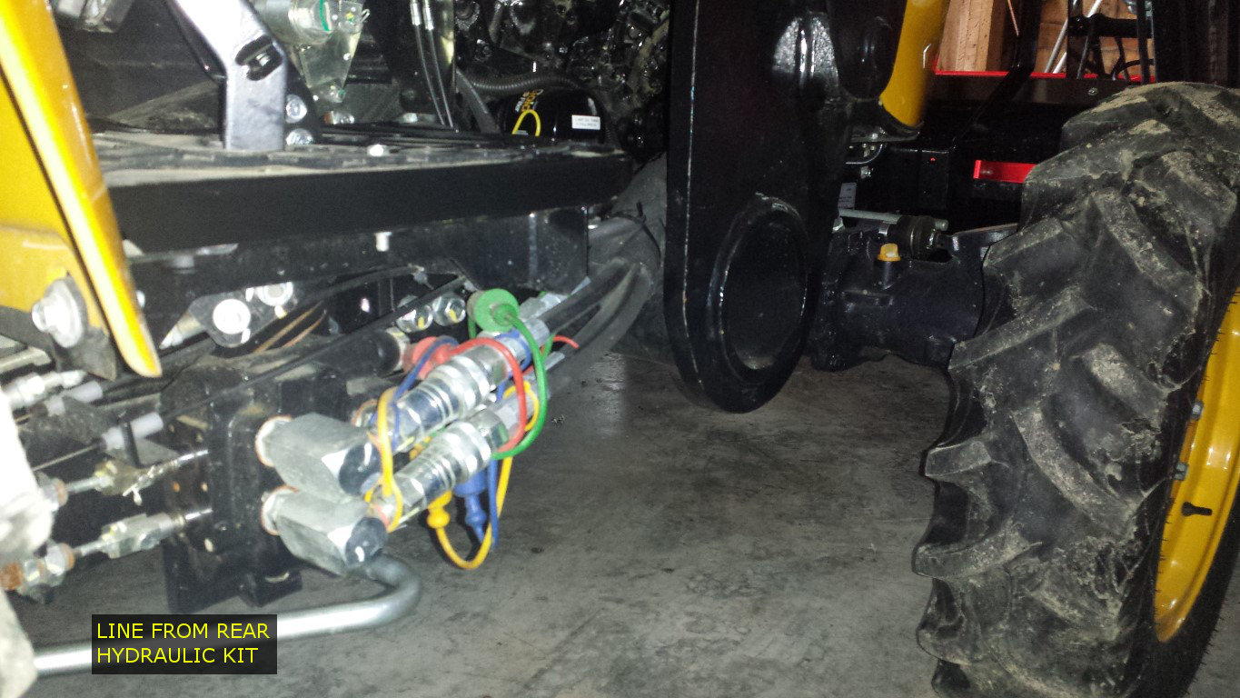

The "hanging down" description doesn't sound right. I have the suspicion someone took off the loader and didn't route the hoses back correctly when they put it back on.
Here's a picture of how the hoses should be routed - up and over the loader arms mount. I can see if they were routed the other way around the loader mount the hoses would be "hanging down."
In the picture I noted a line on my tractor from the rear remotes kit. This line, unfortunately, sticks out a bit more than the one it replaces. But this is a good spot to install a step that might protect some of it. The 18.5 inches of clearance is from the bottom of that valve.
Here's another pic that shows the clearance. On the ground is the line that the rear remote kit replaced. Its a pretty heavy duty line, I don't think brush and small branches would bother it.

Looked at the tractor today and then came home and saw your post. Sure enough something is not assembled the way the pictures show. I have made my peace with this problem after looking at the skid plate thread and some others plus I stopped by a Kubota dealer and looked underneath those tractors. The yanmar is no worse off than some of them. I am going to close the deal on this tractor tomorrow.
