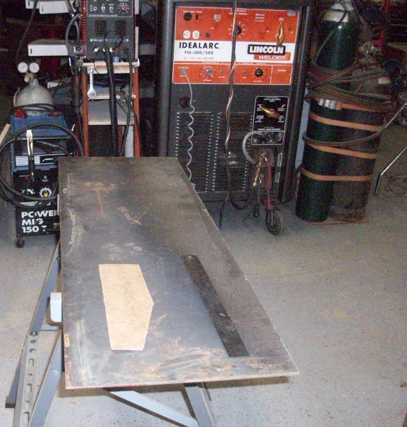

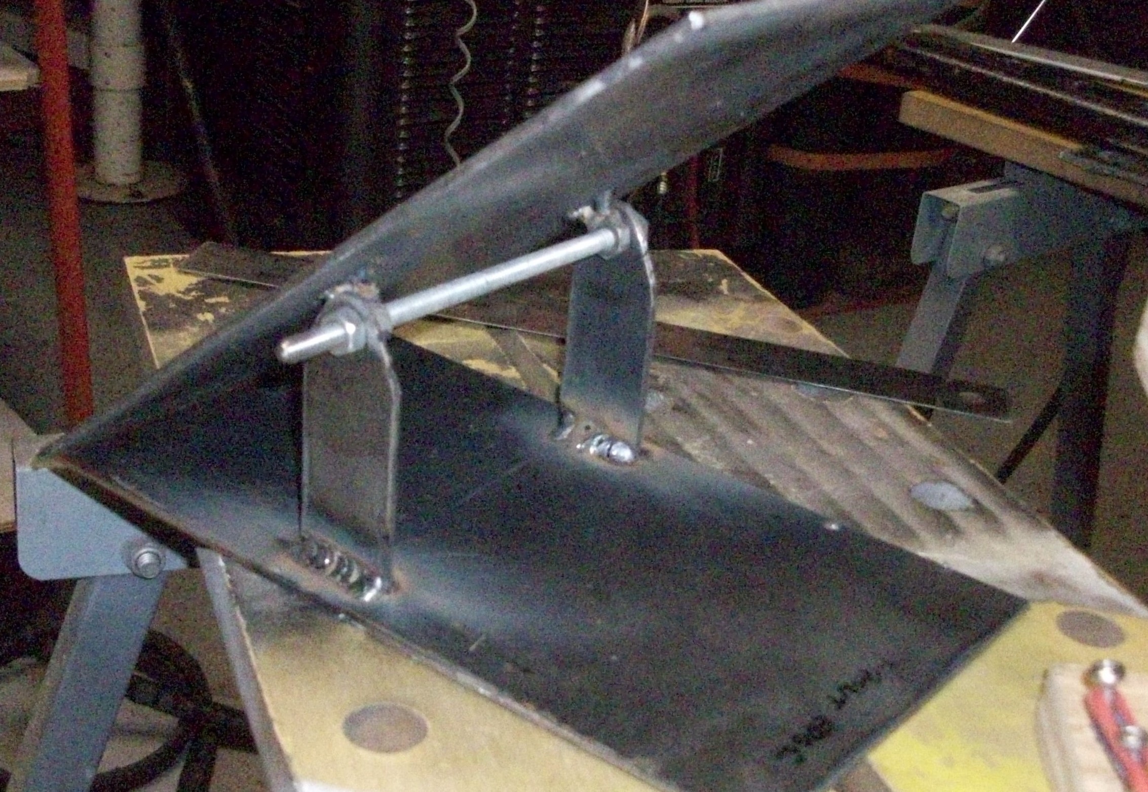

Feeling fairly sure it was going to be ok , I purchased some 10 and 11 gauge steel from leftover cut offs from our local Pacific Steel.
Scribed some pieces out and plasma cut them with my lotos combo unit which did a decent job with fairly minimal dross to knock off.

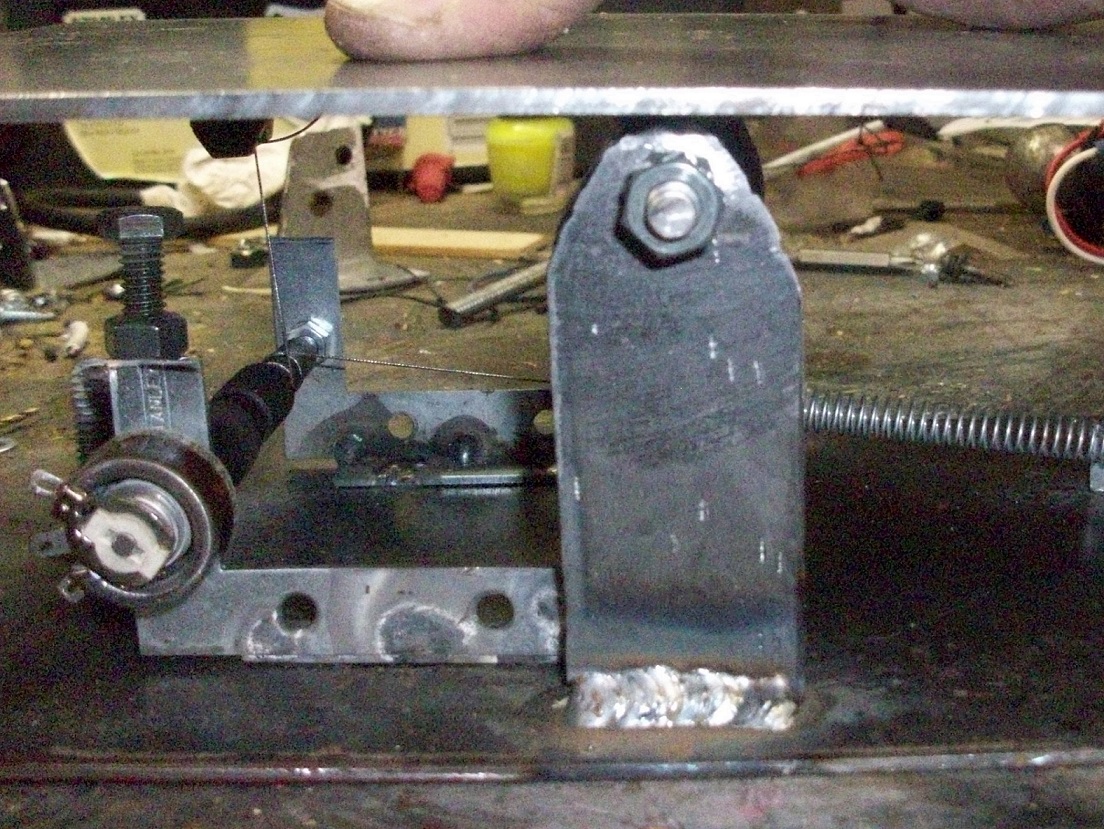

Next added the rheostat and fishing line :D, springs and such 100_8279.JPG

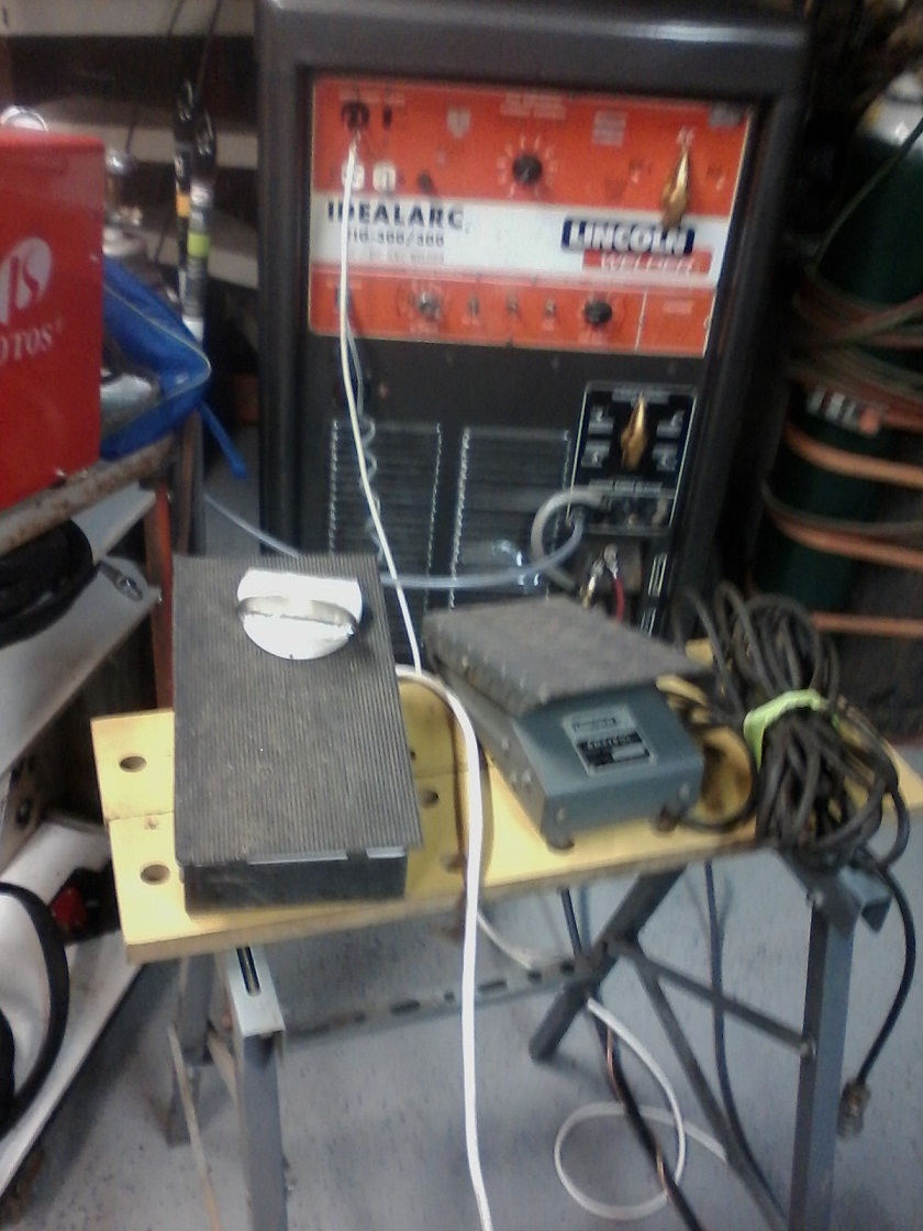

and here it is next to the Lincoln foot pedal

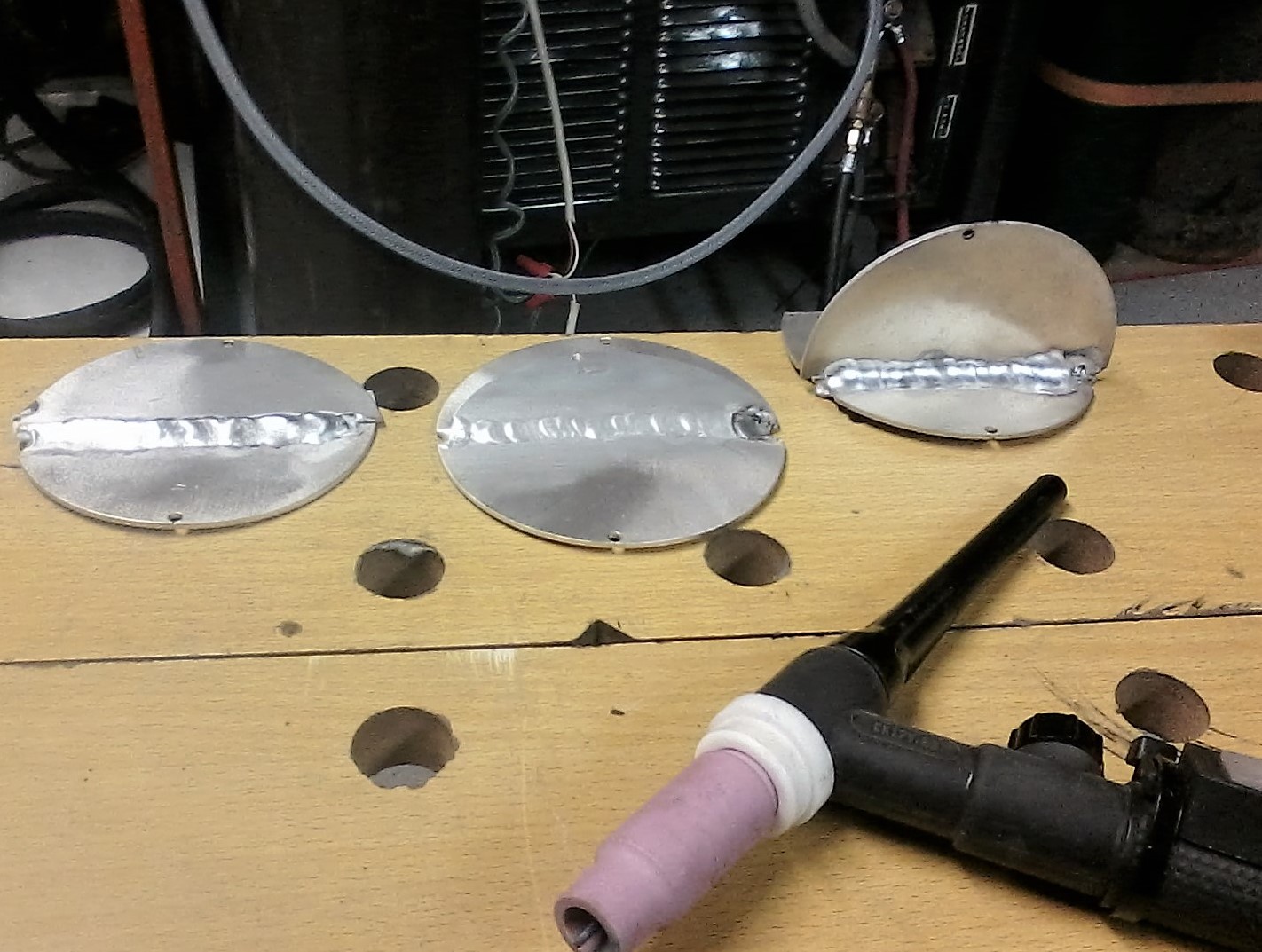

my first attempts at welding some Aluminum .065 circular punch outs with the new pedal
I have a lot to learn and lots and lots of practice to do, but i was able to stick 2 Aluminum pieces together without blowing huge holes :cool2: (at least not on all of them:laughing:)

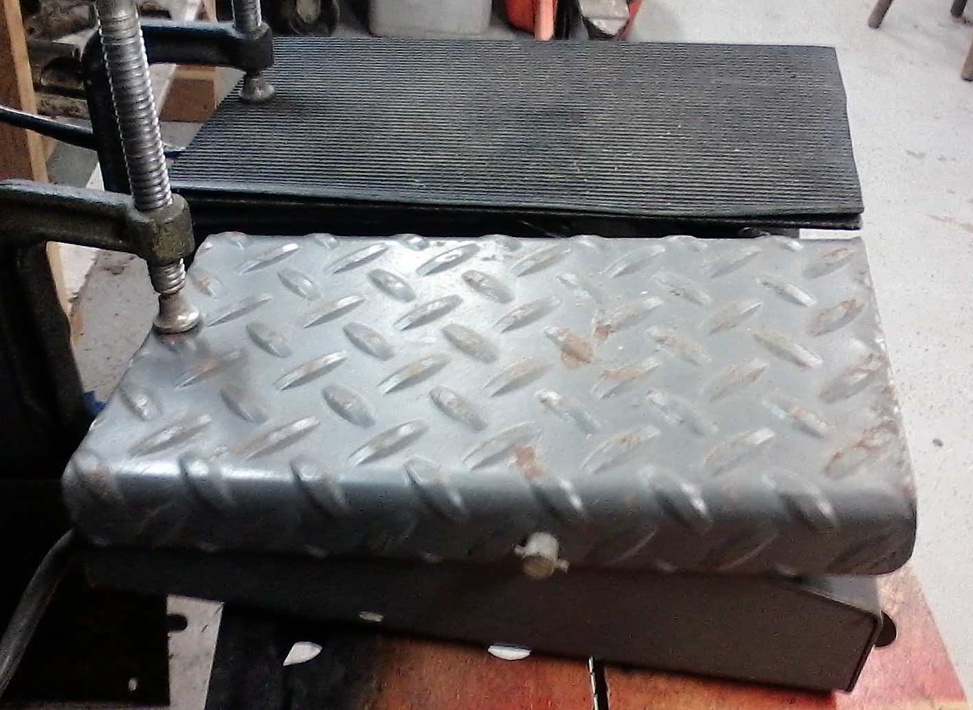

Here is a comparison of the factory Lincoln foot pedal/ and home built unit at extreme travel :foot pedal range 1.jpgfoot pedal range 2.jpg
The range matches the Lincoln very closely, and I really like the way Lincoln designed their pedals , such that you can put a full weight on the pedal and just rock your foot either way a little to adjust.
Most of the units sold for the chinese built units have a combersom large box that is hinged at the heel end of the pedal.
That style looks like it would be very uncomfortable to use for very long-, since you can not put any real weight on it and the control cannot be accomplished by foot rocking.
