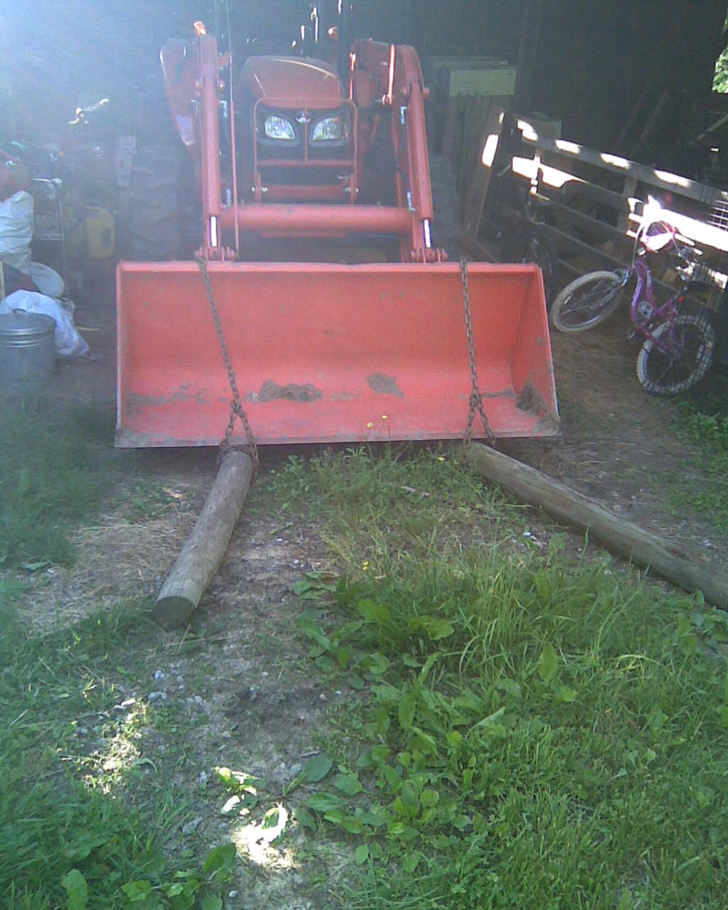

Today I took a couple of wooden fence posts and a chain and made a set of low cost splayed brush/pallet forks. Fairly simple and strong, worked well. The log in the picture is pretty heavy and most of the weight is supported by the "fork" on the right side of the bucket.
If I was to improve on this I would cut a bevel angle on the front ends of the posts, and I would come up with a better way to tie the backs of the posts together under/behind the bucket. The critical attachment is the chain connection that holds the post up against the front edge of the bucket. When loaded, the posts push up against the bottom of the bucket.

Check out my cheap brush forks! :D I got the idea from LostInTheWoods. They work pretty good.
Great minds think alike, my friend. :)
My original post was a little tongue-in-cheek at the time, but for light-duty tasks something like this is amazingly effective. For a total investment of about 10 cents worth of chainsaw fuel & oil, it serves quite well.
