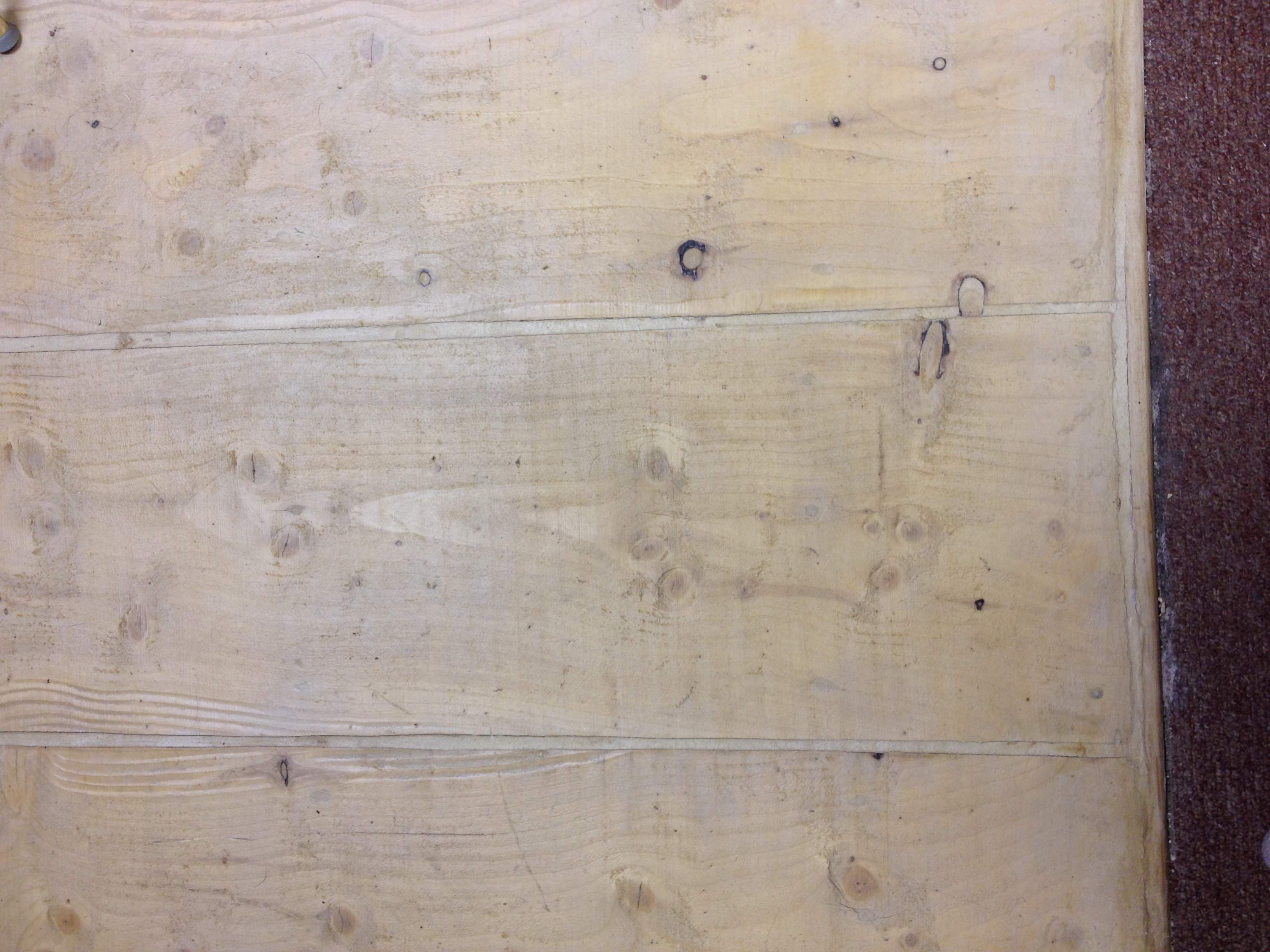

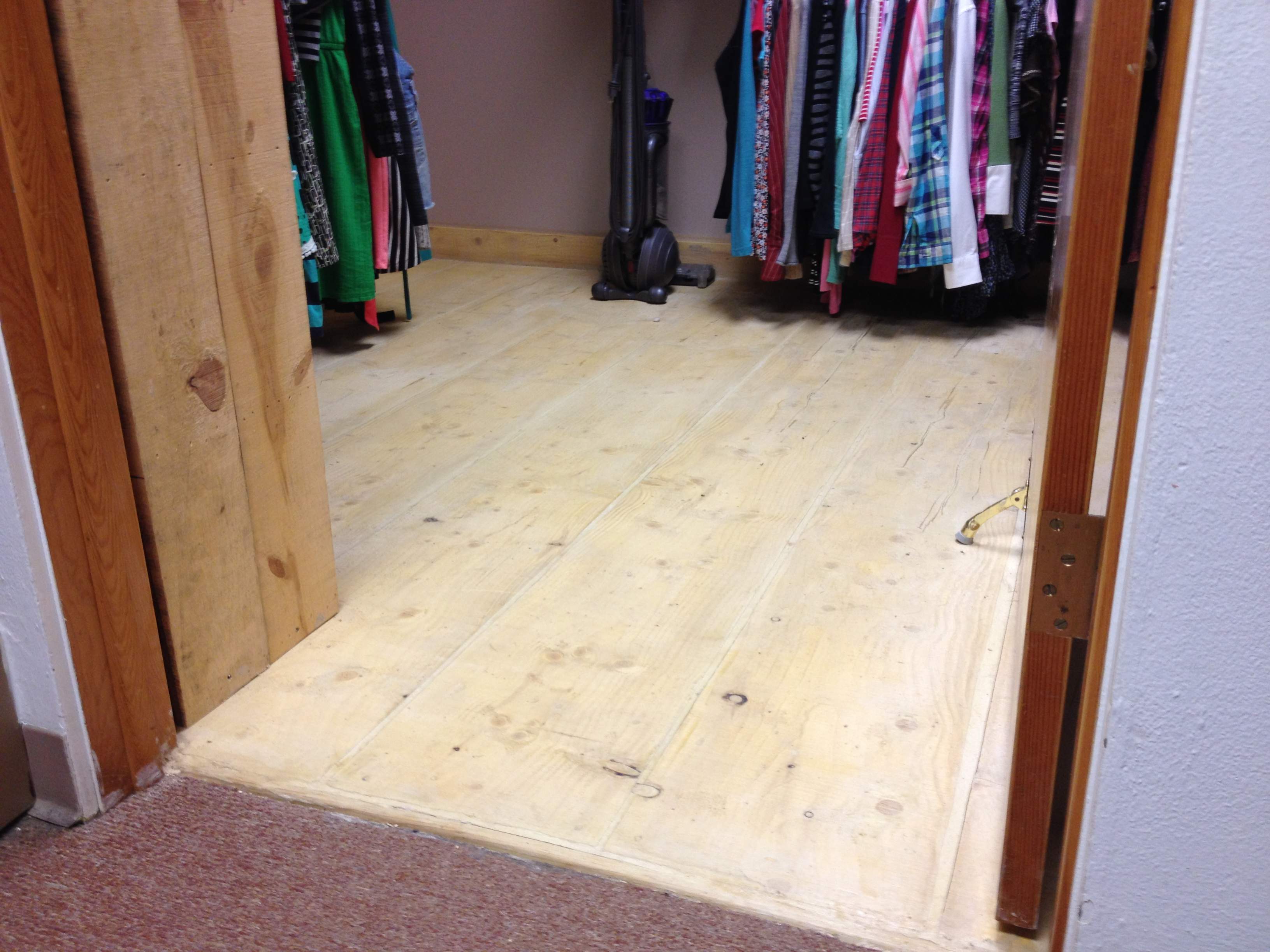

I did a closet with 1/2" thick rough sawn spruce. I laid it green and when it shrunk up I grouted the whole thing. Put a couple coats of thinned spar urethane and it turned out looking pretty nice. Pardon the dog hair.

I used great stuff subfloor adhesive and a framing nailer to lay it down. Some pieces had a big crack from a lightning strike so I left them because I thought that was cool. Grout filled them in.

What type of grout did you use? How long has the floor been in use? Is it holding up well?
   / Low cost finish floor #26
I just bought a bag of colored tile grout at menards.
http://www.menards.com/main/floorin...-sanded-grout-650-25-lbs/p-2229883-c-6582.htm
Been using it about 6 months. I noticed the spruce was soft so I thinned down the spar urethane so it would soak in deep for the first coat. I laid it on heavy. It seemed to make it much more impact resistant. I've used spar urethane on exterior marine applications so for a closet I suspect it will hold up pretty well.
