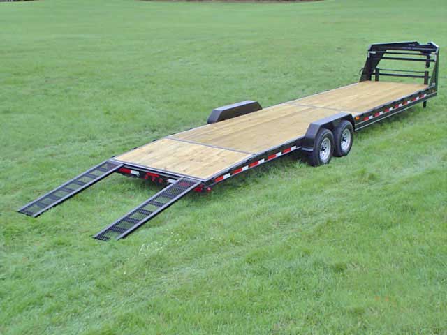

What about a trailer like this? Can get with 3 axles of needed for more capacity and lengths like you need, Drive over fenders and 102" wide in front and rear of fenders. Definetly would be lower than a pierced beam. A dove tail and longer than stock ramps should achieve the angle you need. On mine, the 3 point lifts the disc higher than the fenders. Just an idea
   / Low profile (pierced beam) or standard ??????? opinions wanted #19
IF you like drive over fenders.... i personally don't.. but that's me..
