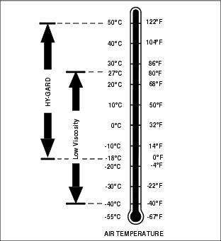

My 4410's manual says the recommend low vis but then they have a temperature chart that says ony use low vis to 80 degrees F. and that seemingly Hy-gard should be used for higher temps and it is suppose to be good down to 0 degrees F. My dealer (parts man) says they put low-vis in everything. I live in NC were it very rarely reaches 0 and if regulary exceed 80 degrees. Does any one know the pros and cons of the different fluids.

/ Low vis vs. Hygard
Greg.
Where is the temp graph that shows them both to be good to 122? This is the one in the 4410 manual.

Seems you didn't bother to follow those links I posted.
"PMB10102: For commercial and consumer applications, the temperature range for Low-Viscosity Hy-Gard is 40F (-40C) to 122F (50C)
*Check the operator’s manual for specific applications. Some applications are restricted in this temperature range
Note the "*". Since your manual has a different chart - and assuming it's not unusual for temperatures in your area to exceed 68F - you apparently have a tractor that should use the thicker HyGard.
