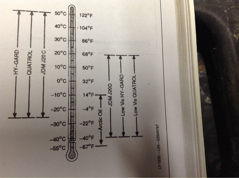

Here's the chart from my manual, I rarely operate it at below 10 F, and if I did, it would be a slow warm up before I worked it. And I definitely experience 90F plus days in summer.
So which kind would you use?
   / Low Viscosity vs Hygard #16
Going by your chart, I would use the HyGuard. Your machine's design calls for down to about -14F. Your machine's design rejects the use of the Low VIs Hyguard at just warm spring temps.
When it is -14F, I wash my cloths in Tide. Too cold to wash them out-tide.
prs
   / Low Viscosity vs Hygard #17
I was pretty sure that I'd written the right oil down going by the chart, but what was the dealer talking about?
On the other hand, I see a lot of people run low viscosity all year?

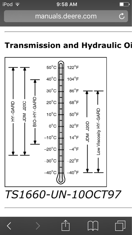

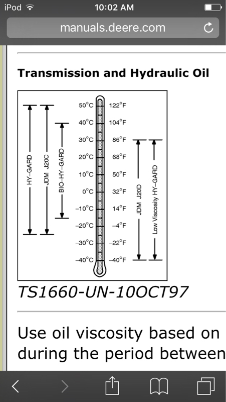

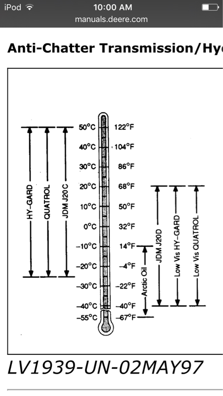

These are hydraulic oil charts from 3 different JD 5075 manuals I found online. A 2014, a Indian version and a 2015. The last is from my 2012 manual
Basically, for some they say upper range of low viscosity is 68 degrees, for others they say it's 86 degrees.
Why different temp ranges?
What should I use for tractor that sees 5F to 95F?
