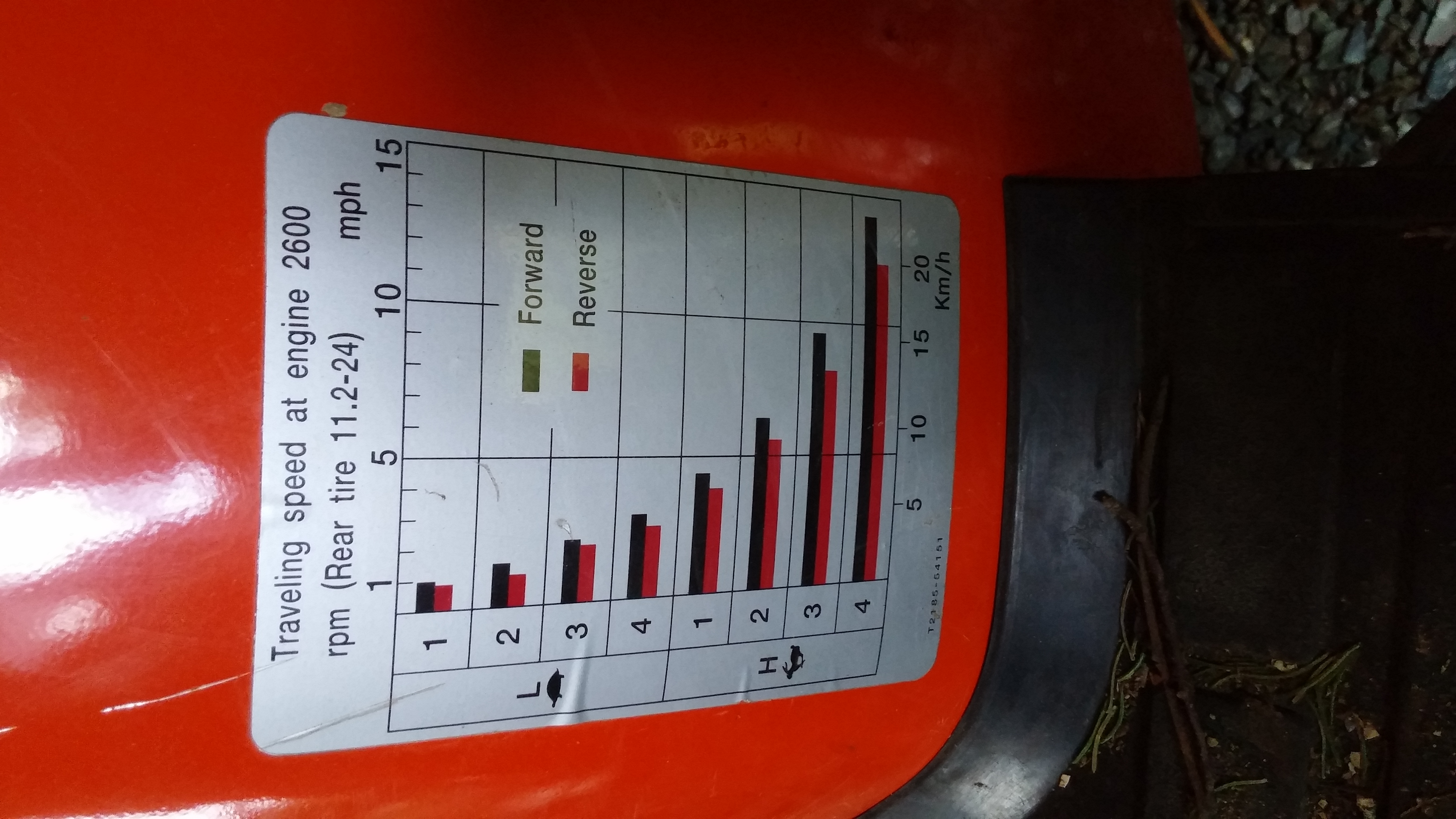

   / Low vs high gear? #22
CK series have stickers or at least mine does!
   / Low vs high gear? #23
yeah, my sticker is half hanging off.....
Seems a lot of folk have no idea about the gears on a Kioti shuttle. LOL
I use 2nd gear for nearly everything including flail mowing at about 2000 - 2200 rpm max My Flail here.
Rarely use High unless I am naughty and out on the road..... which I shouldn't be. (but hey, country road and the neighbours do it to)
Low gear for all my loader work using 4x4

   / Low vs high gear? #29
Manuals usually do have the info. I know all the kubota manuals I have seen do.
But its ONLY in the manual, and not usually published anywhere online unless someone has uploaded the info to tractordata.
It is in my manual, and a sticker on the tractor also. It is always in the workshop manuals
   / Low vs high gear? #30
That makes more sense. I like the sticker idea that some have too.
