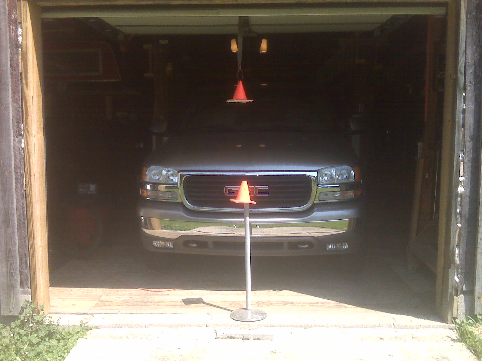

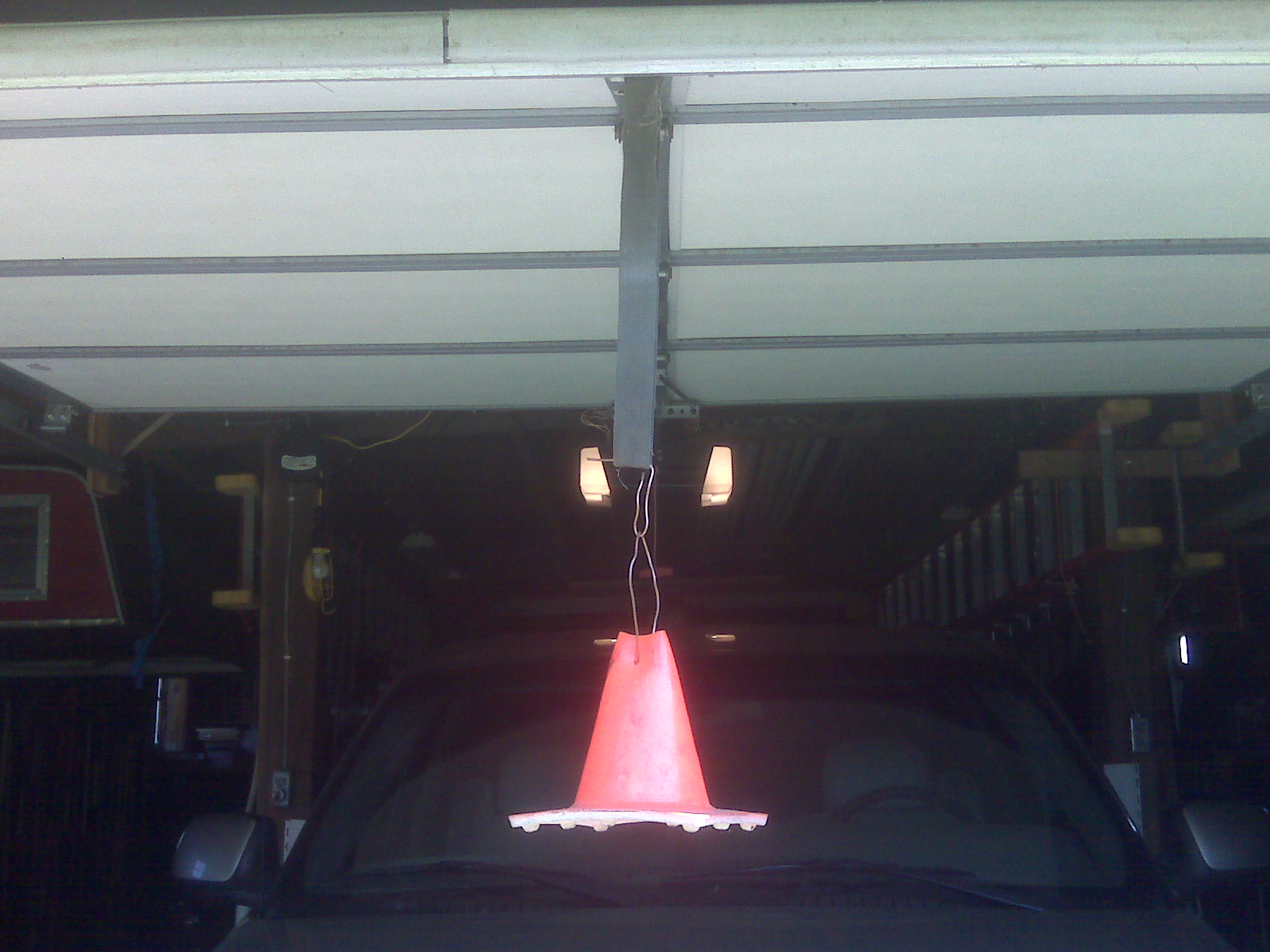

There is no need to hit your garage door header with your ROPS because you forgot to fold it !!! After you pull the tractor out and raise the ROPS, place a sawhorse, a trash can, a folding chair, etc in front of the door with a sign on them that says "LOWER ROPS". Or do what I do, I have one of those big orange traffic cones that I have painted a big black "LOOK UP" on, and I place that in front of the door.
/ Lower ROPS #27
That's a good idea...
/ Lower ROPS #28
I used to use these methods: One or both...if you cannot recall why you put those cones up better not put the ROPS up. :laughing:
