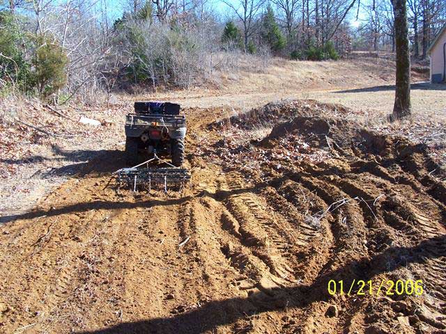

Cool, any way to build a frame to pick it up level? I built I little 4' harrow from 1/2" solid bar and some t-posts for deer plots. Pulls easy behind my ATV. While testing it out the other day in some root infested ground I noticed it trapped a lot of stuff. Just pucking it up from one side and the stuff just fell out. Might rig it up on the 3pt. But I like how I can go faster on the ATV.

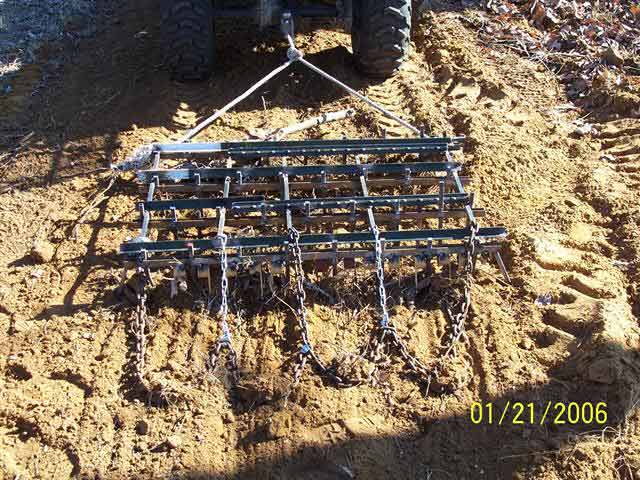

And a second....
Ain't pretty but it works OK. Does bust up the clods.

I used an "x" bracing with the boom pole and it pick's it off the ground very well...and it was something I had laying around...simple and easy

yep that's the one I remember seeing. Cool how with those spikes straight down how the little roots just slide off. I need to go steel..errrrr borrow my BIL gin pole that he never uses.
