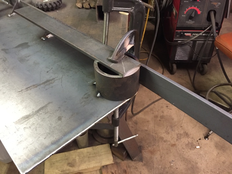

After she left I ran it for a few minutes on the piece of 3/8 x 2 1/2 flat I was trying to bend. I was able to bend it slightly (with great effort), but was not able to get it cherry red.
Could be that I didn't have the work positioned correctly in the max heat zone of the flame ... but it seems to me that the flame pattern is just way too large. I could probably set something up with a couple of fire bricks to confine the heat into the target area ... but that could be a little awkward and unwieldy.
For $15 I'm sure it will have it's uses ... but I'm not sure bending steel will be one of them.
One thing is for sure ... it will be handy to take the chill out of the shop on a really cold morning, until the stove gets going. During the time I ran it, the air temp in the shop (32 x 28 x 8) went from 78F to 91F ... :D

I've never ran one, just witnessed them in action. Never thought they could be used to heat and bend metal. Tin maybe. As you said, can't concentrate the heat enough. Justifiably so since they are designed to distribute heat over a large area. :)
