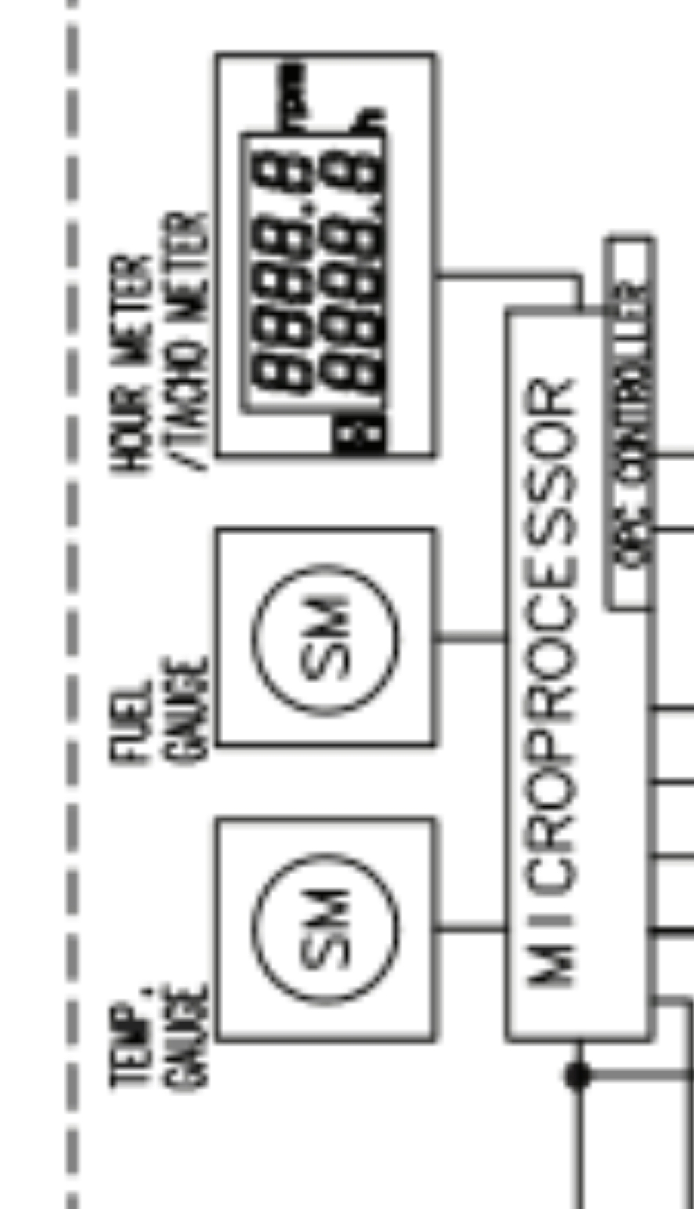

The hour meter, gas gauge and coolant gauge do not work. Everything else runs and works. Checked fuses and all look fine. Any idea's?
/ LS 2025h tractor #2
In the manual the only correlation between the 3 is the instrument panel itself or a chassis ground.

I don't know LS but "back in the day" some of the instruments did not power directly from twelve volts. There was a lower voltage regulator (think five or six volts) in line to feed instruments. It may be part of the instrument panel and not shown as a separate component.

Thanks for reply. I think it's the panel also. Trying new fuse and if that doesn't work it will be time to call for service.

Ok, put in new 10amp fuse. Turned on key and gas and rpm meter still did not work. Turned on heado8ghts and flashers. All of a sudden gauges worked. Turned everything off. Turned key to on and gauges worked. Thank God I didn't gave to call service.
