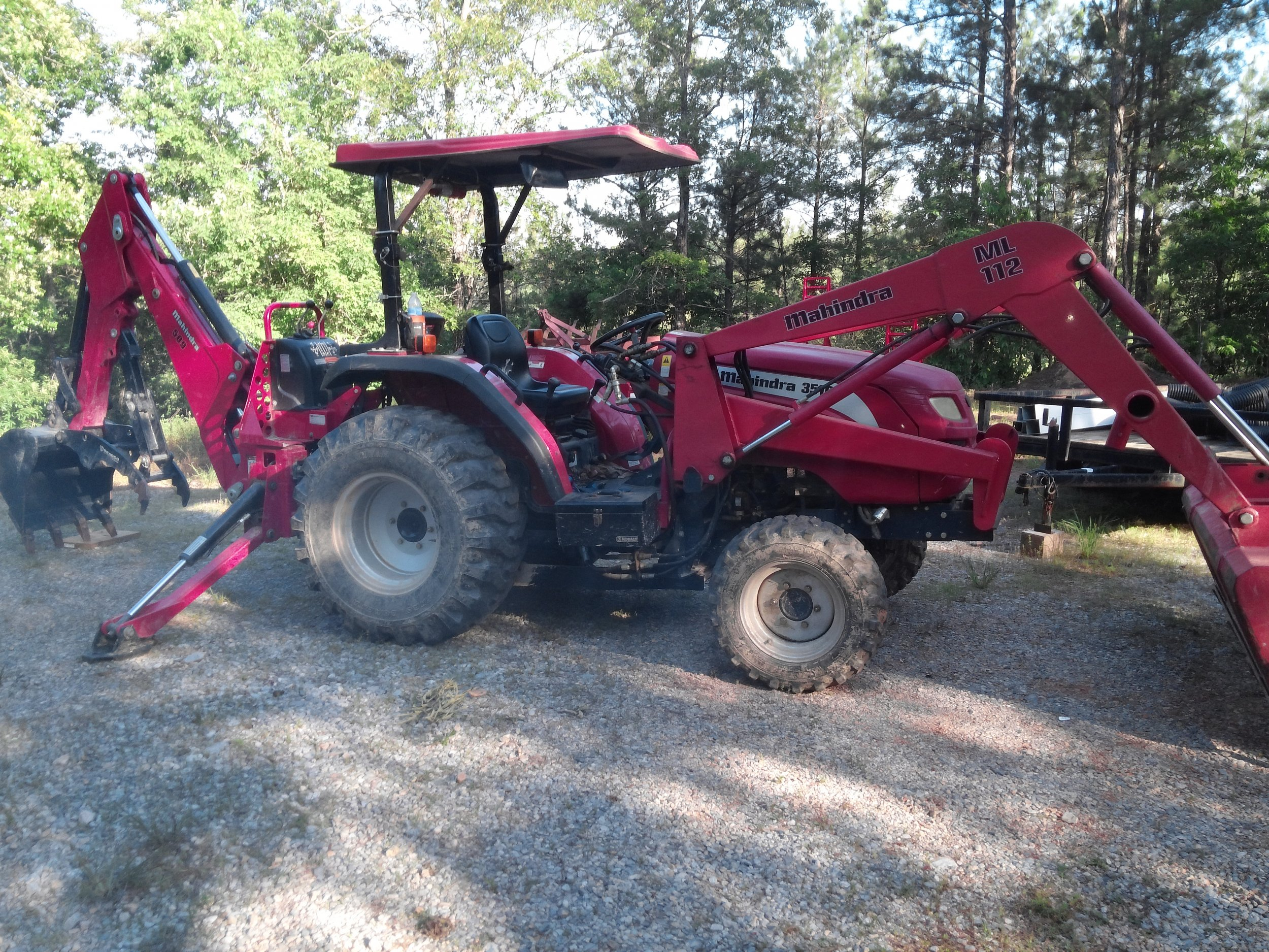

I dont think Mahindra (or any other mfg) will warranty a tractor with a BH cobbled on it. 3 pt backhoes are tough on the linkage. A subframe mount that fits the tractor is best option.
BTW- I put a BH on the 3510 several years ago and the subframe was $1k plus backhoe cost. Dont regret it at all, one of my most useful attachments next to pallet forks.
