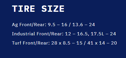

That’s good to hear. Maybe my questions were too hard:
Can R4 tires be mounted on factory R1 rims or do I need new rims (XR4140H)?
/ LS Email #10
The front rim size is different between the R1 and the R4:
The biggest problem is making sure that the OD of the front and rear stays at the proper ratio to match the drivetrain. If it doesn't, you will rip your drivetrain apart in 4WD. The R4's are wider than the R1s, so I think you would need a wider rim.

What is so FRUSTRATING, someone at LS has to have this info at their finger tips. Why can’t they communicate it? If nothing else wouldn’t the parts or shop manual have the info?
/ LS Email #12
I found that on their website. I believe it is also in the owner's manual spec page. I agree, though: they should have that info available right in front of them. Your dealer should know how to get it at the very least.
