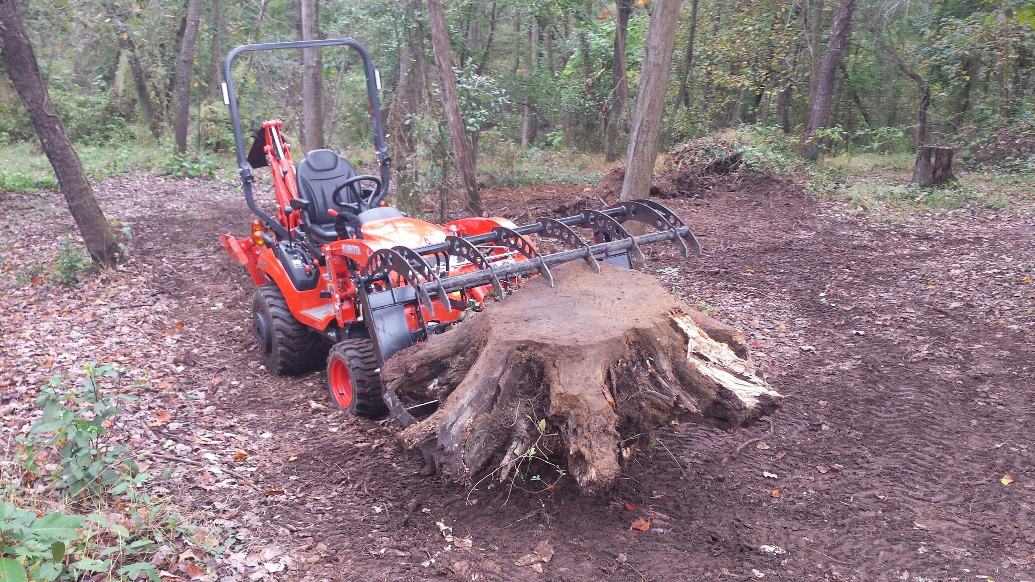

How big diameter log have you picked up with your grapple. Where did you buy it from?
I bought it from Everything Attachments. They have 2 threads on here above in the general forums about grapples. I have some pics near the end of them. I just got it and was getting used to using it, so my technique was a bit off. I need to keep things closer to the tractor when picking it up. Even with my bad technique, I was able to pick up stumps that almost lifted the rear of the tractor. This is with both the backhoe and wheel weights on. I did bump up the hydraulic pressure to 1950, and that gave me a lot more lifting power. Unless you are planning on lifting things that are really heavy the 23S will probably do the trick. If it can't, then you may want to consider a B model.

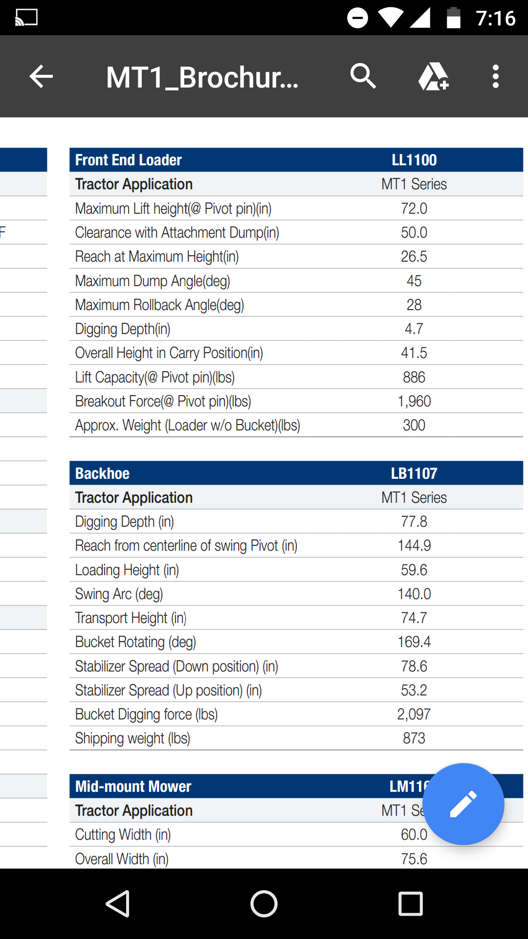

I looked at the LS MT125 last night, and the lifting power wasn't that much more. One thing I noticed is when they did the lifting power of the FEL, they didn't say at what height that is. If that is at the ground level, 5 feet or max height. Kubota is pretty open about that. I have attached a PDF that shows the lifting stats and the second page is the lifting curve on a graph. The lower it is, the more power it has. FYI - it is in kilograms, not pounds. :)

Here is a pic of a stump I moved today. It is a giant poplar tree stump. It was the max my BX could do, and that is as high as I could lift it. There were a few other stumps (oak trees) that I could not lift, but I clamped onto them with the grapple and drug and pushed them to where I wanted to. If you are patient, you can pretty much do whatever you want. :)

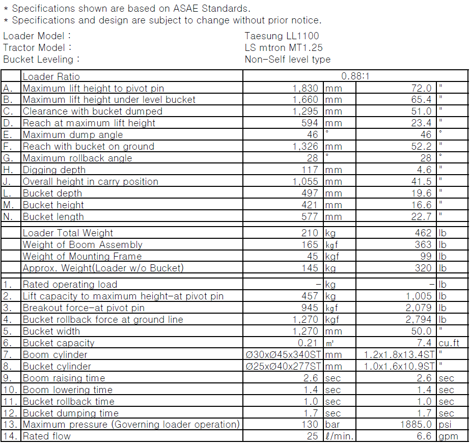

The LL1100 loader for the MT125 manual says 1,005 lbs at max height (72") at pivot pins. That is 457kg.
Thanks for that. I didn't notice that on the website last night, unless I just plain missed it. :)
Makes a bit of sense since the Kubota has a 1.57" bore and 12.8" inch stroke, and the LS has a 1.8" bore, and 13.4" stroke. Bore allows more force for the same pressure.
