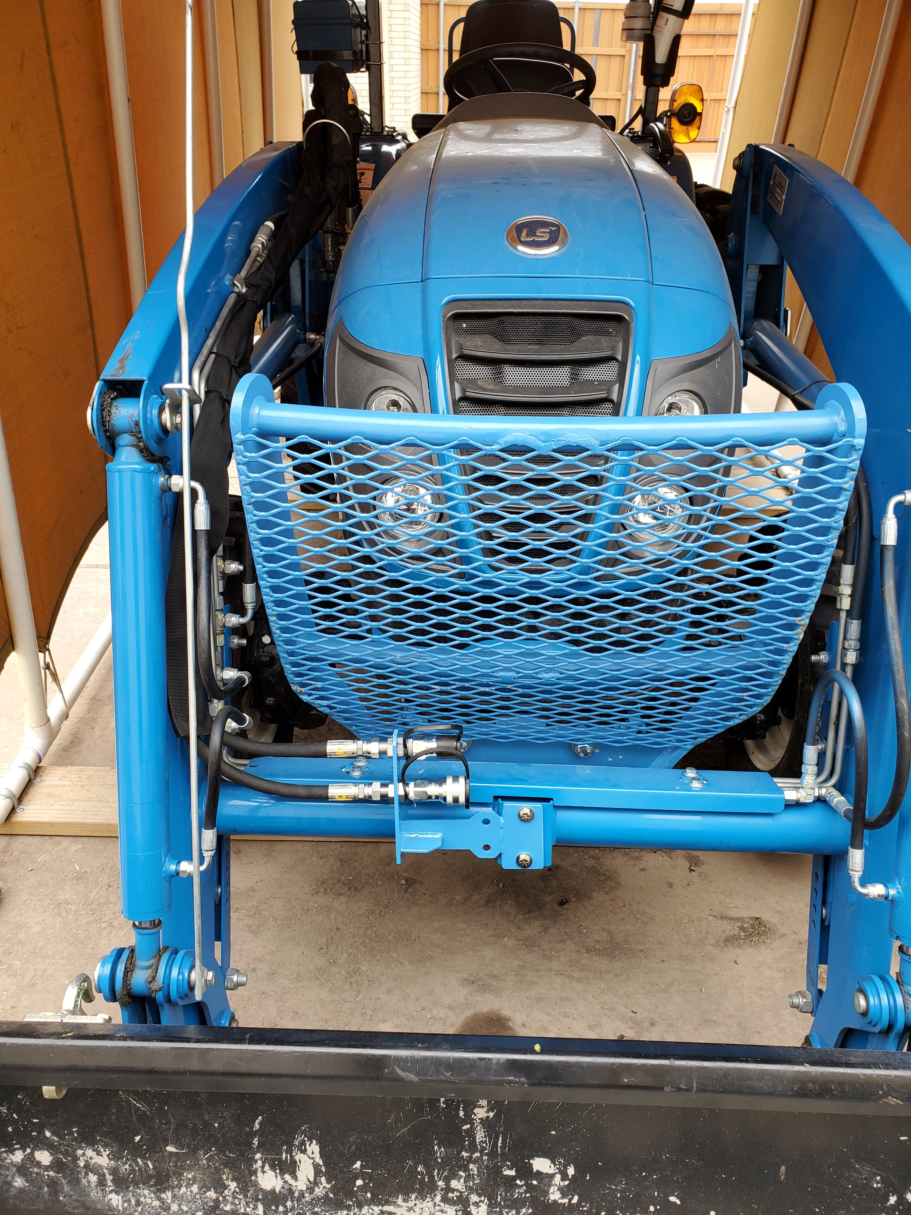

Install went pretty easily, just took time, but some of that is I may be a little too meticulous.
Only a few issues.

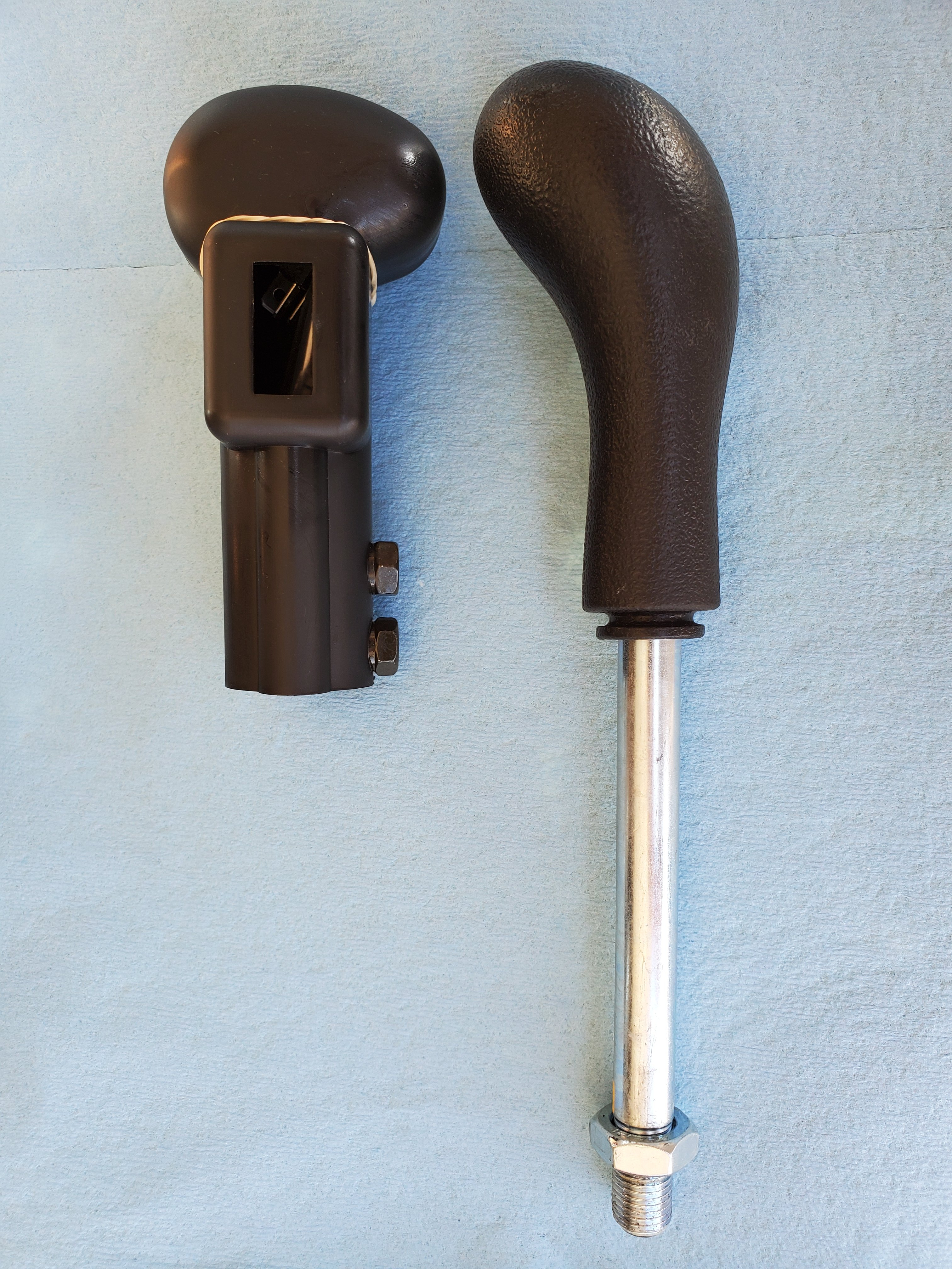

The handle modification wasn't clear or really accurate in the procedure in the kit. The video made it easy to do though.
The bolts on the FEL weren't long enough to mount the control valve assembly as the instructions stated and the holes in the WR Long bracket were too small so had to drill those out and install longer metric bolts.

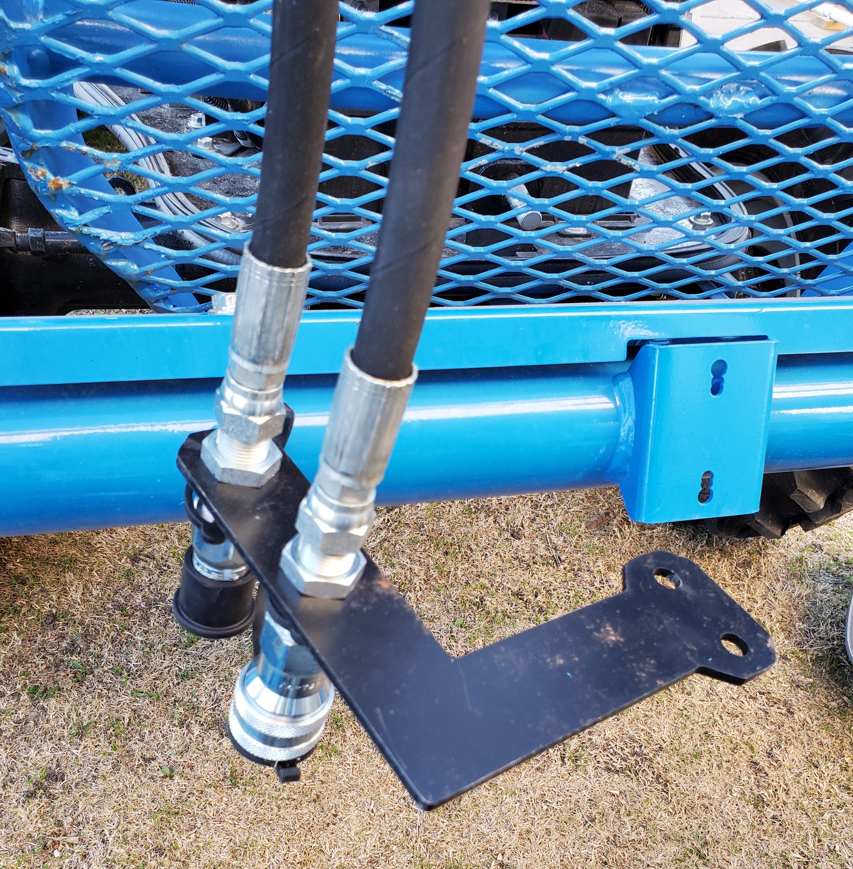

Biggest issue was the FEL mount for the hose's on the coupler end. The bracket I think was to be mounted onto the torque tube hardline cover but I didn't really like how it positioned them so I modified the bracket more to my liking and more like I have seen others position them, parallel with the tube.
