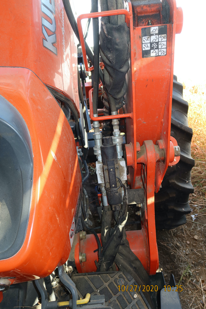

I installed the WR Long one on my MT240 and it wasn't difficult at all. If you have a cab , that may make it more difficult, not sure.

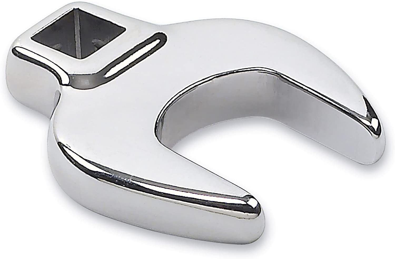

On mine, a crowsfoot wrench was the only tools I had to purchase to complete the install easily.

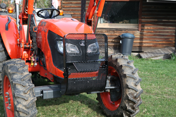

Eight years ago. Had the dealer install a Land Pride 1560 grapple and WR Long 3rd function valve. Also had expanded metal added to the grill guard.
Never had a moments problem with any of it. Money well spent.
What is a Crowsfoot wrench?
