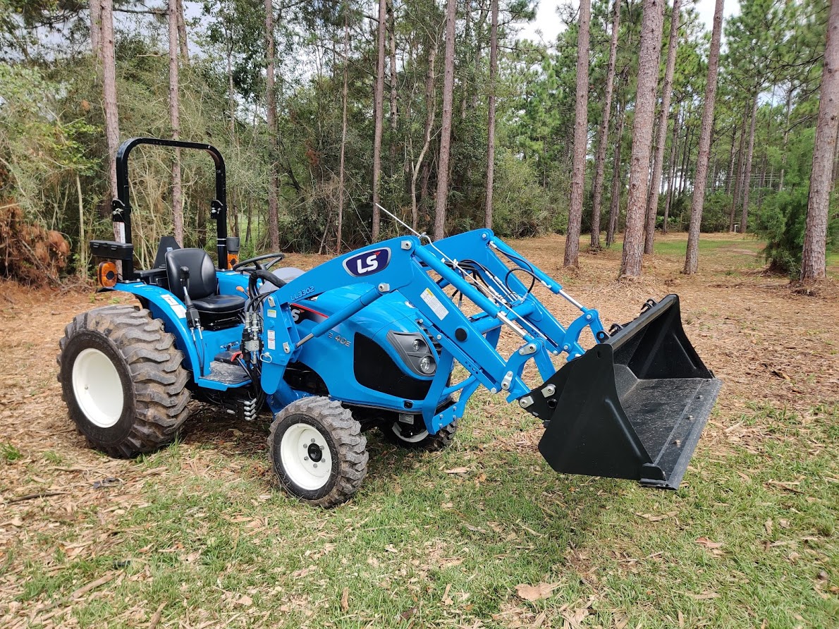

I have the XR3135H and it runs a 5' medium duty rotary cutter fine. I'm cutting overgrown wooded area brush (mature grapevine and asian bittersweet vine, predominantly). Basically I'm using my FEL a couple inches off the ground to ensure I dont hit rocks and stumps, it knocks down most things, then the rotary cutter chews it up as I go over it. It has handled some fairly brutal stuff.
I got the 5' because I knew I'd be using it this way, not as a mower.
Here's an example. The cleared area on the right was exactly how the uncleared area on the left started out when we got the property. 56711097_602640843583457_813966276199186432_n.jpg

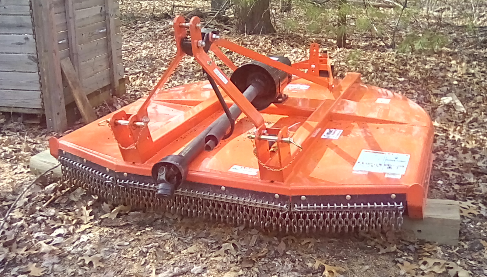

My LS is 41 hp (33 pto) my track is 6' wide.
I am looking at brush cutters, most everyone recommends getting a 6' to cover my tracks but,
1) I won't be cutting much grass or any fields
2) I will be mowing a power line a couple times a year
3) I will mainly be using it for brush cutting in the woods & swamp
I am thinking of just getting a medium to heavy duty 5' cutter because of maneuverability and substantial cost savings, plus I don't think having a cutter quite as wide as my tires is that important for my uses. I am afraid with a big 6' I will be banging into trees all the time!
Need some advice, what do you think 5' or 6' ?

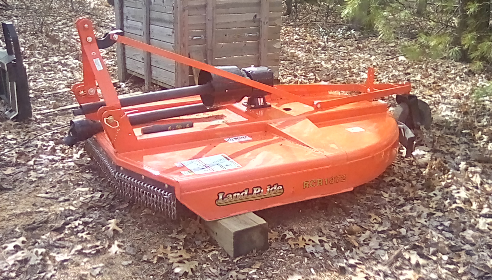

Went with the 6' because I found a good deal on a very gently used Land Price RCR 1872 on Craigs List!
Thanks for the help.
How has that Land Pride held up? Still happy with your choice?

Very happy with it, bought some new blades for it, but still cutting with the old ones! I have 2 Land Pride implements (Rotary Cutter & Rear Blade) and am very satisfied with both of them! :thumbsup:
