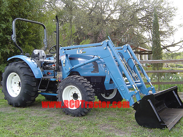

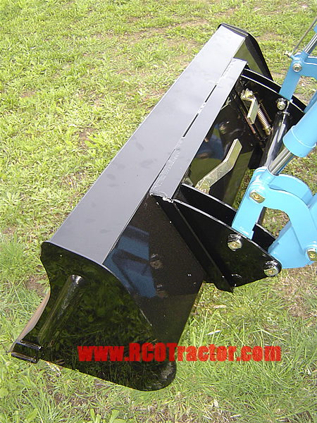

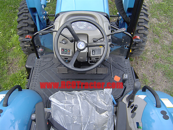

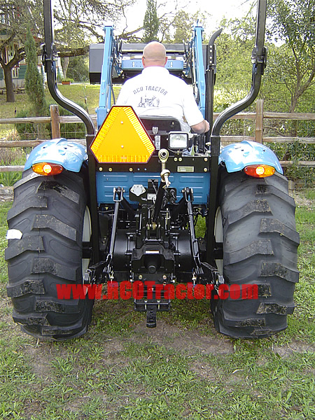

Hey folks. Thought I'd post some pics of the LS U5030 57 HP Utility Tractor.... it's a NIIIIICE machine. I'm real excited about the line, the warranty, the LS organization.... We're confident they're going to be a big winner and make lots of tractor buyers real happy! We're not total experts on them yet, but we'll do our best to answer any questions anybody might have about them.

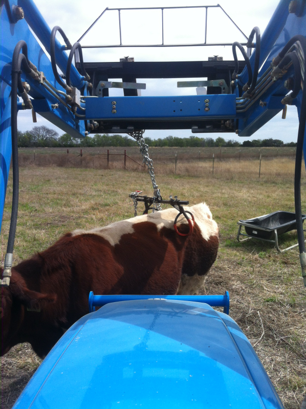

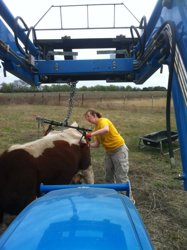

LS U5030 picking up 1600lbs of cow that had some birthing issues, my daughter in law treating her.
HS.

Neat pic's Scott ! Thanks for shareing, also that camera takes clear pic's ! :thumbsup:
Boone

Lost calf, 100lbs was the issue. Cow is still alive but will most likely be put down this weekend if she can't get up. A real loss you are looking a full blood pinzgauer.
HS

Has she made any effort to stay up with the lift on her? She probably has nerve damage if she was in labor for a long time. Wife and son have 50-60 head total, I've seen it happen and it's hard to deal with but it does happen. If she's just weak and worth saving I'd call the Vet. It's strange but around here it's cheaper to get a Vet to come out, even in the middle of the night, and treat a cow than it is to take a dog or cat to them. Sometimes a good dose of calcium or glucose, can't remember which, will help if there's no nerve damage. Good luck.
