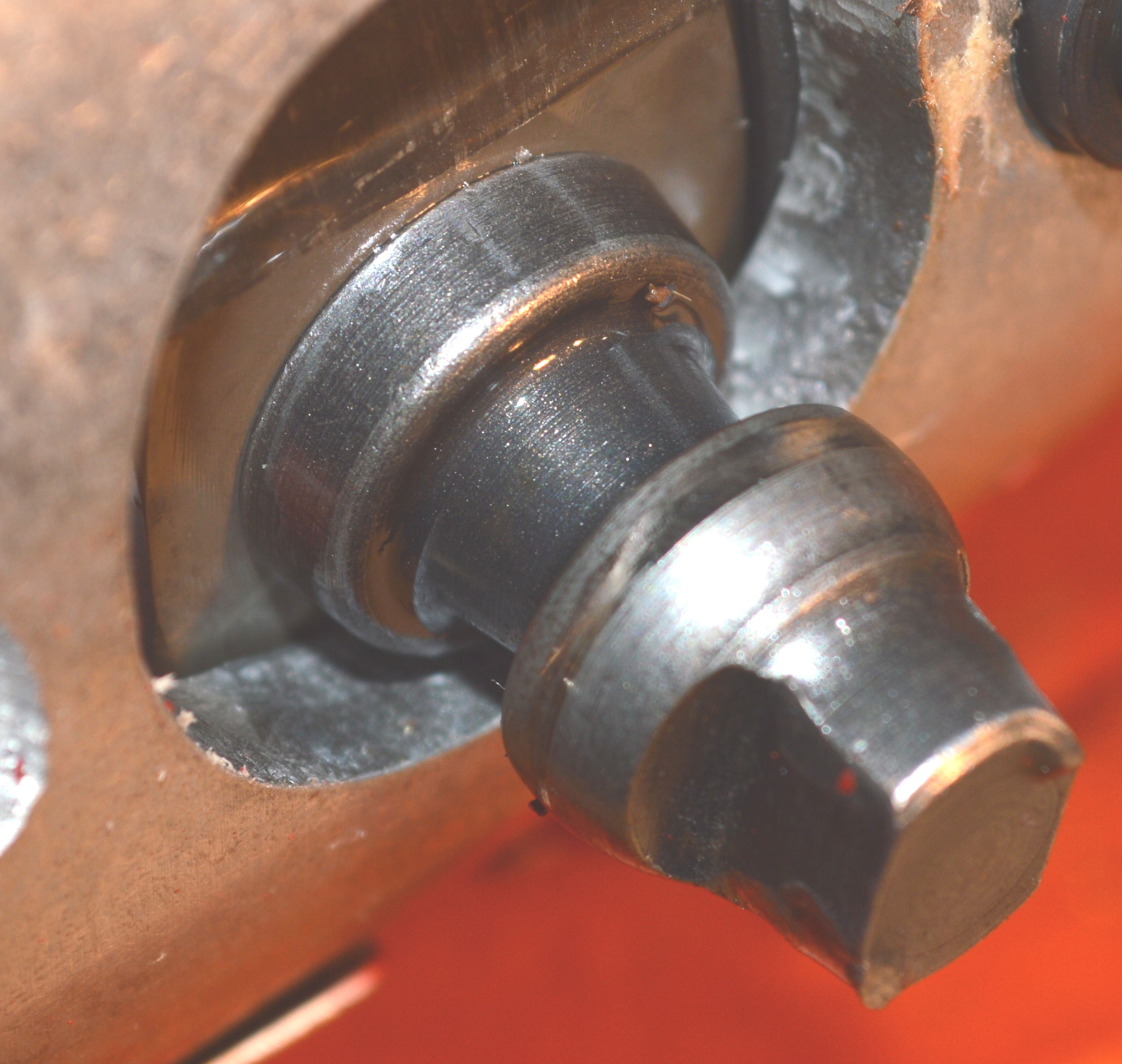

3- Cannot change it cause cannot remove this lever

3] That piece is called the cam ball.. it takes a special tool to remove it.. its made of soft metal & will round over if the tool is not used.. I've gotten them in rounded over & the trick is to clamp the "ball" in a vise & "smack/turn" THE PUMP..

It's the threaded part of that 'cam ball' that worries me, I've already put some big torque ft-lbs to it and any more will break the screw in the hole (I'm presuming it's turn-left to unscrew). I tried it in the wise but mine doesn't give the accessibility I need, I've already done some rounding. I'll figure out something. I find these manuals extremely flimsy and superficial

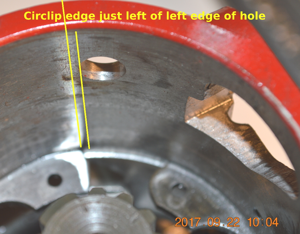

..up the creek with very few other suspects, maybe the question of the circlip not being in the middle of the timing window under the 'cover-plate' where it's supposed to be, I still have to wrap myself around that one

The C clip in the housing wont ever be centered in the housing.. its moved for timing purposes..
